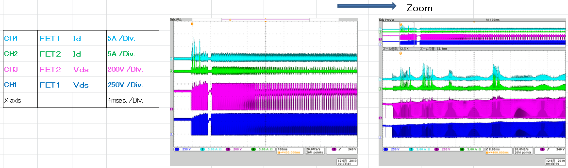

Problem is unstable switching current on choke coil, please let me know about idea for correction points.
Condition and waveform is below;
【Condition】
・Vin: 200Vac (180V~264V)
・External components;
・At first startup UCC28070 on no load.
 When increase output current, choke current become unstable on the moment of discontinuous⇒continuous current.
①Iout: 0.6A (Discontinuous choke current)
 ⇒Although a little waveform disturbances, no problem.
②Iout: 0.7A (Continuous choke current)
 ⇒Waveform is disturbances and stable on these condition.
   I guess that it should sdjust Ton time.
③Startup timing (Iout: 0A)
 ⇒The same waveform as ②.
   Startup sequence is;
    200Vac (with 20Ω rush current limiting resistor) → When UCC28070 Vcc startup, limiting resistor is short by DC relay on the same timing.

  • Hello Satoshi,
    The Excel calculator recommends a value of 16 Ohms for Rs and your design uses 33 Ohms
    It also recommends a value of 72kOhms for Rimo and your design is using 47kOhms
    This is a 2.3kW design and you are only using 660uF output capacitance.
    This will give you an output ripple of about 32Vpp.
    The low capacitance can easily cause the UCC28070 to go into OVP so the PWM will shutdown and restart.
    I recommend that you check Vout and increase Cout as required
