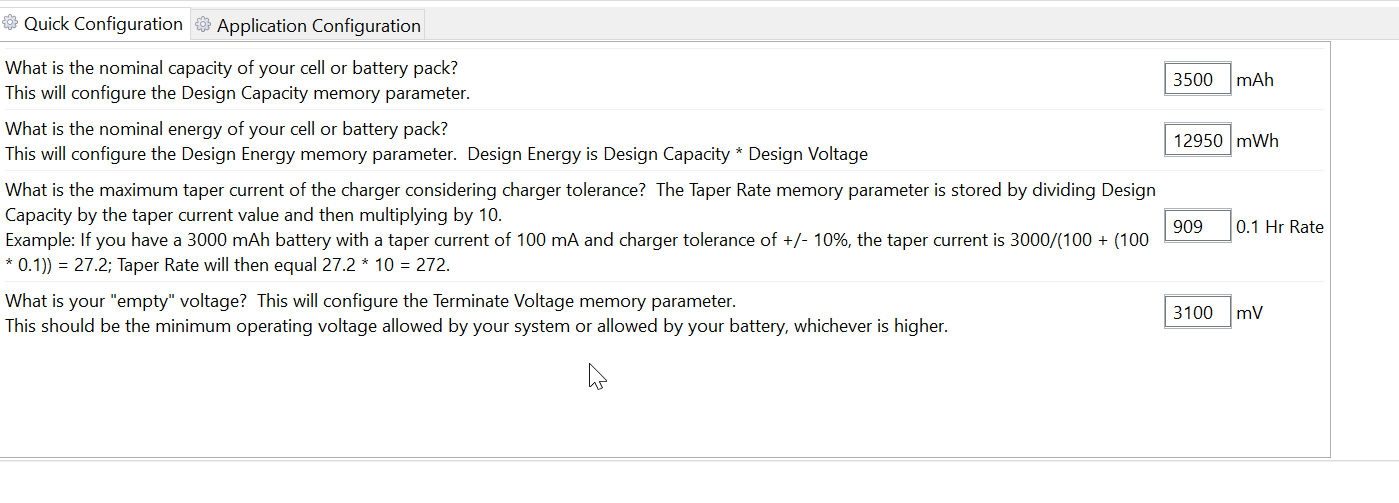

I'm using chemistry profile 1202 (4V2) and
1. Question

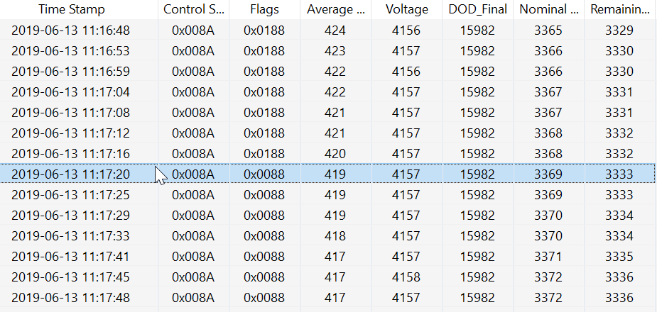

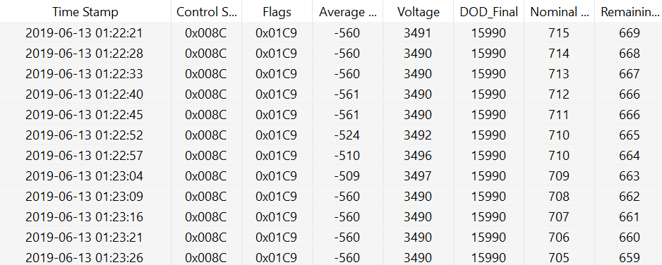

Why is the CHG bit set during discharge?
2. Question
Why is the CHG bit reset during charging?
and at least:

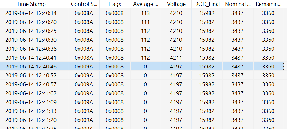

Why goes the fuel gauge into sleep mode even charging is not finished? (Taper Current 35mA)
The charge setup is: terminate when FC bit is set.
Make I something wrong, or must I consider more points when I use the learning cycle in bqstudio?
