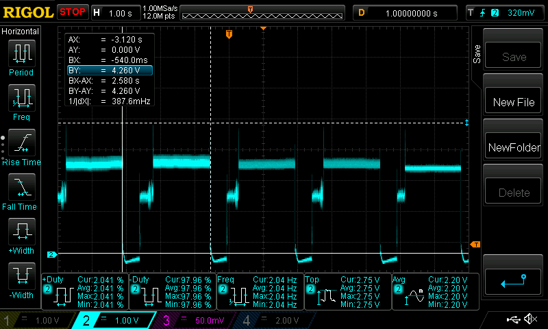

I've tried many C(coil)1, C(coil)2 combinations with several coils of different sizes and inductance and I am unable to get voltage outputted from the device.

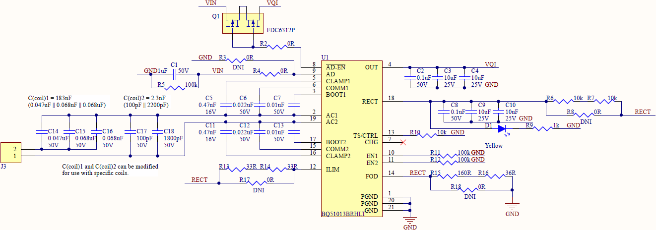

I'm using my own custom board, and I tried it on four different boards; however, the problem still persists despite using various inductors and capacitors, with two different transmitters. I used Figure 48 on the product's datasheet as reference for my design.
I captured Vrect for review.
The RECT cutoff timing changes depending on the capacitor values chosen. I used the calculations as a base, and then I change out C(coil)1 and C(coil)2 in an attempt to tune it but I still haven't been able to get it working yet. Do I just need to keep trying different capacitors to tune it until it works, or do I have a different issue?
How should I go about troubleshooting this problem? Thank you for your assistance!

    The schematic look OK.
    1.) R-ILIM R13 / R14 is a little low may need to increase, but do not think that is the problem
    2.) R-OS R6/R7 for now remove, value needs to be set later.
    The scope capture looks odd.  The jump in voltage may be the output turning off and rectified voltage jumping up.  Problem would not be the jump but why output turns off.
    Could you check the output vs RECT?
    Also typical RECT start up waveform attached.4062.bqTESLA FAQ--Start up.pdf

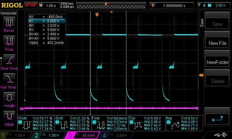

  • Hi Bill,
    Thank you for your feedback! I increased R13 and R14 to a total of 113Ω, combined with Rfod at 196Ω gives a total Rilim of 309Ω.
    Also, I temporarily removed R6 and R7.
    I think the oscilloscope reading only looks different due to the locations of the coils. Vrect (blue) still doesn't look like the Start Up example that you provided. Vout (pink) never seems to become active. Is there anything else I should try?
    Thank you so much for your help!
  • Thanks for the additional data.
    Unfortunately it does not help -- Vout does not move.
    What is your output load, could you test with a resistive load?

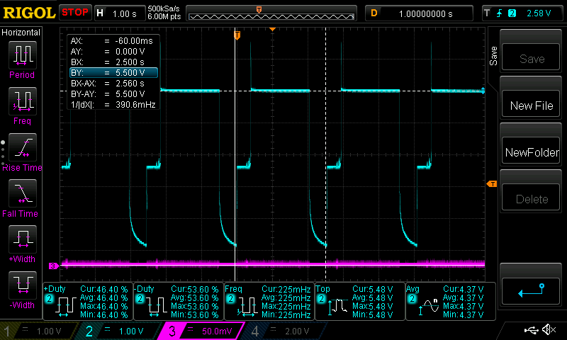

  • Hi Bill,
    The previous oscilloscope captures had no load on Vout.

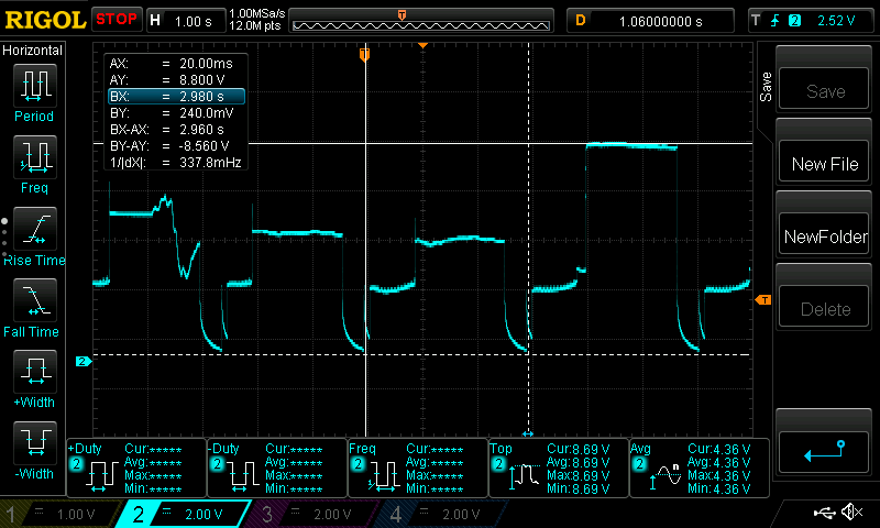

    I used an LED with a 510Ω resistor as a load and captured the following oscilloscope reading:
    Here is what my coil V looks like. For all of these oscilloscope readings, I have C1(coil) = 183nF and C2(coil) = 2100pF with Ls = 12uH. I have tried many different combinations, but I can try a specific combination if you'd like me to get an oscilloscope reading of different values for comparison.
    Some inductors that I have readily available include: 12uH, 13.9uH, 14.3uH, 16.7uH, 25uH, and 47uH.
    Thank you again for your help!
  • Hello
    This does not look like an inductor or tuning problem.
    The RECT has a sharp jump then goes flat.  We can see the RX is sending Control Error Packets (CEP) when the voltage is lower and voltage is moving.  It could be the TX changing operating point very quickly then comm is failing.
