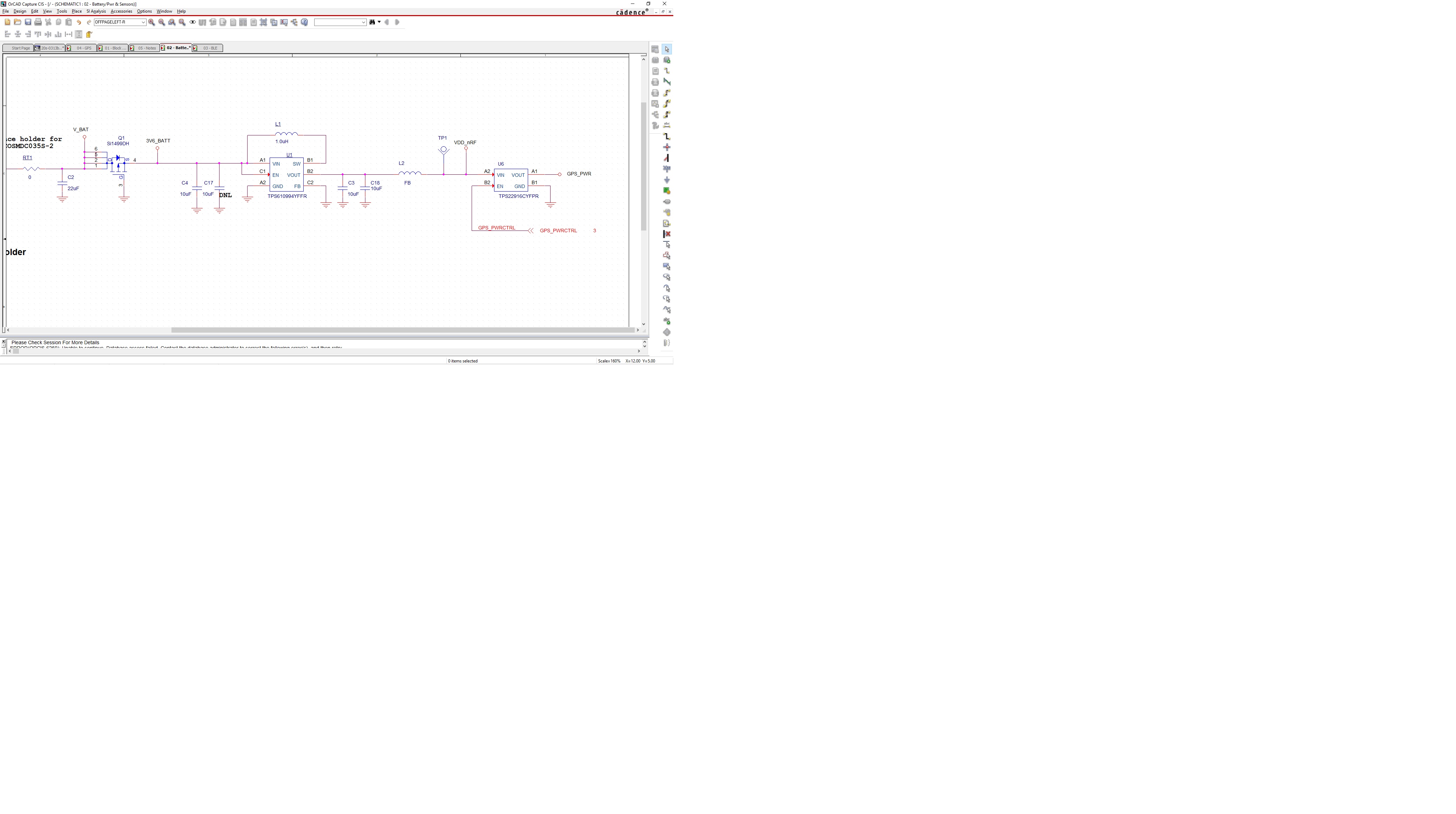

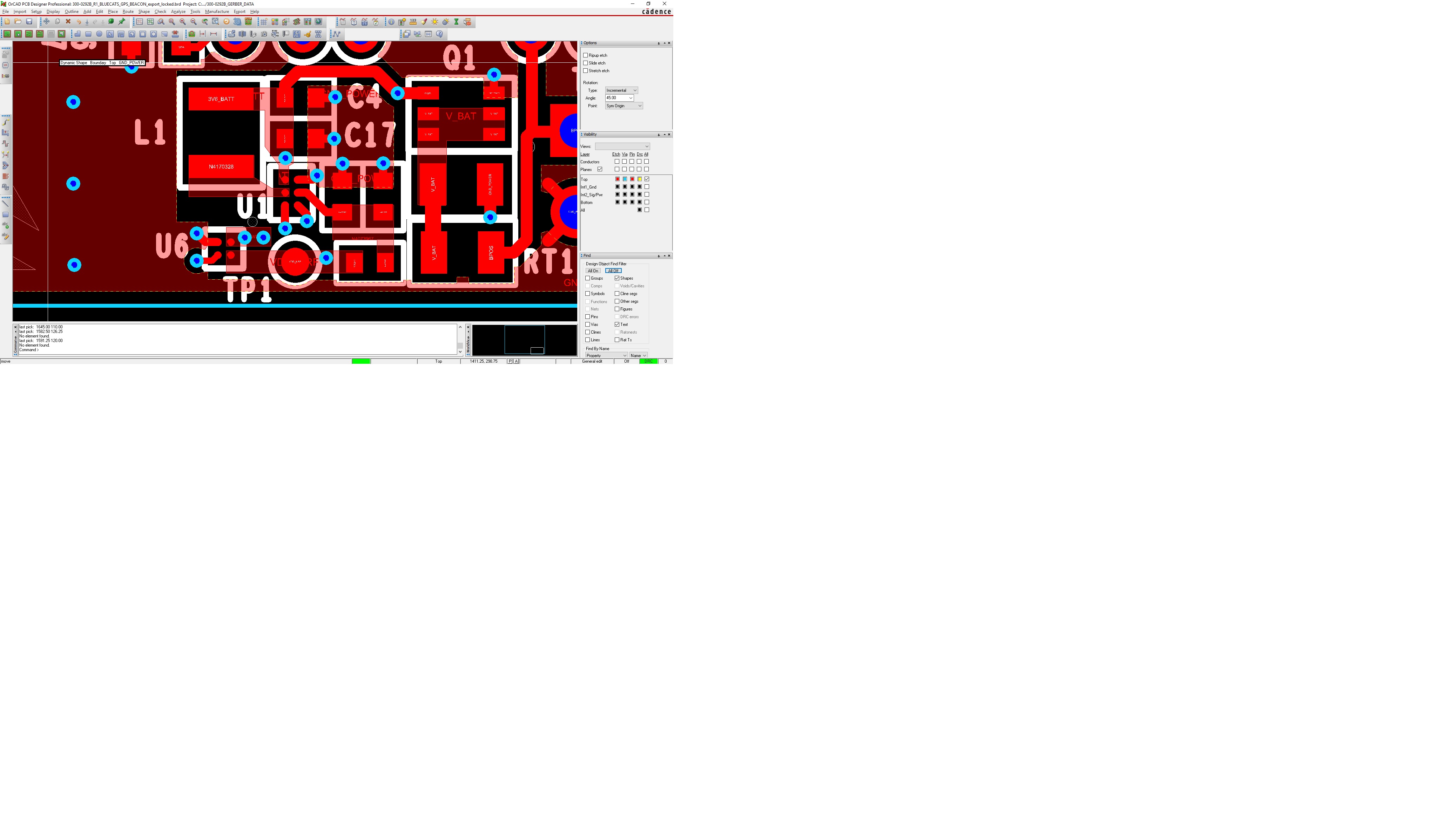

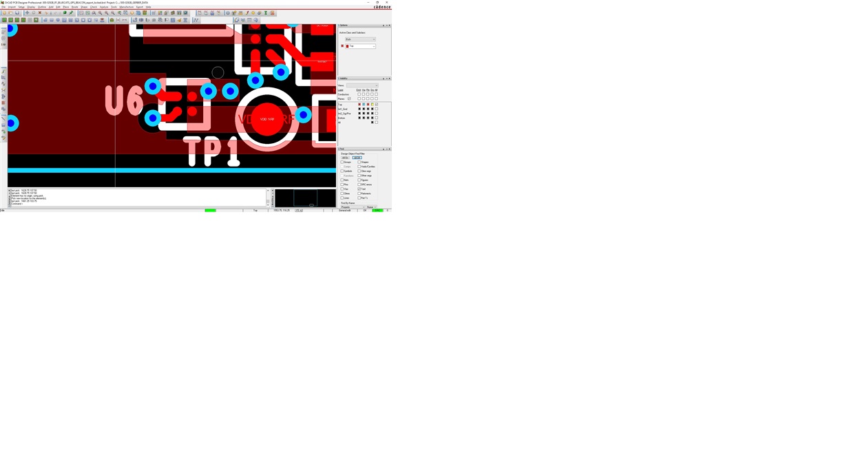

We are one of your distributors and have a customer who ordered 250pcs of this load switch p/n TPS22916CYFPT and states that on a batch of 50pcs that 3pcs are not switching at all or correctly (please see customer's comments below). The customer also provided images depicting the portion of the part's schematic and layout (please see attached images). We need to know why the customer may be having these switch failures and how they may resolve them.
Can you help us with this? From the customer's below problem summary and their attached images, can you provide why the customer might be having a 6% failure rate with this load switch part? Can you provide any suggestion or tip(s) that they can do to resolve such? Can you please email your answers to me at dan.rapp@mouser.com with "S489723" in the subject line?
Customer comments:
“We are using PN# TPS22916CYFPR in one of our products and have seen 3 failures on a small run of 50, Two of them do not switch and the other switched but after a few seconds switched back open. We are using a 3.6V battery regulating down to 3.3V which then goes thru the load SW. These failures are observed during checkout, I have attached a section of the sch and layout for your reference. Any thoughts on the reasons for the failures? U6 is the load SW.”

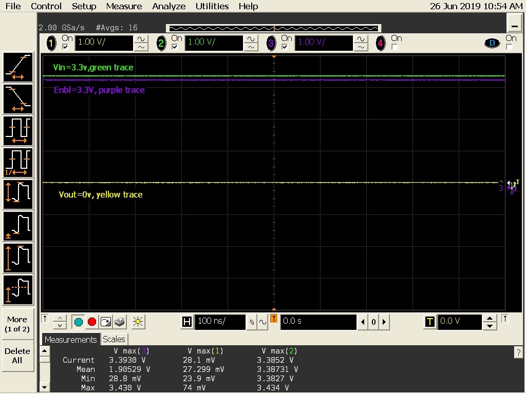

    3. If they could provide oscilloscope shots, that would be appreciated.
    ( I have attached a picture using an oscope of the failure) SM

    Since you mentioned that the device fails during the initial startup, the failure could be potentially due to an initial voltage/current spike. What is the downstream loading conditions? What is your load capacitance? If you could also share an oscilloscope of a working unit, this will help us compare the results.
    Have you tried repeating the test by removing the DC/DC converter? Does the behavior still occur?
