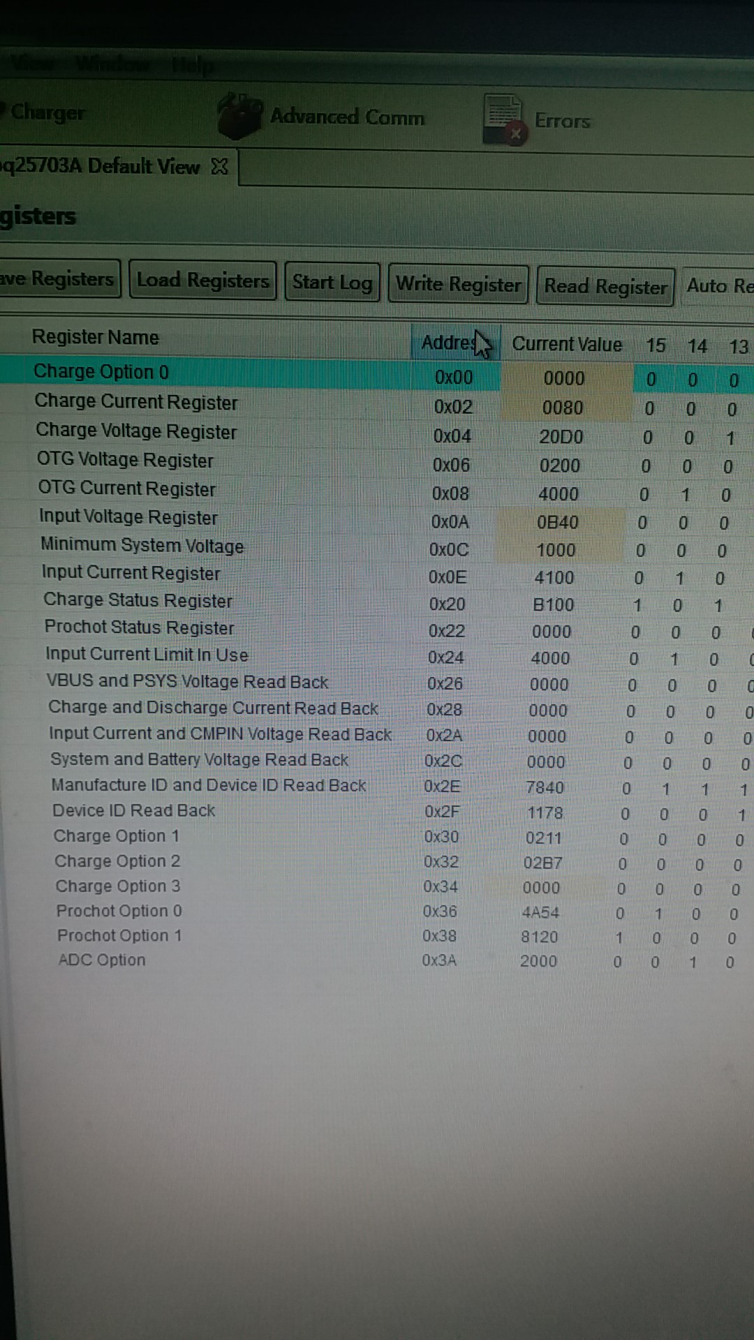

  • Hi Joel,
    I think we don't need compare the register dump firstly. Also because there are some registers that can't be configured at all.
    As shown in the picture, there are many registers of BQ25703A. My question is simple that what can I configure BQ25703A if I 'm a novice engineer.
    1 If I want to change the output current of the chip, which registers must be configured
    2 Or to put it another way, I need a example to understand how to use it. Can you help provide an example of a charging current of 5V 3A?
  • Hey Kun,
    Register 0x0A should be set to a lower value than the input voltage, which is 5V in your case. Currently, with 0x0B40 programmed, the input voltage regulation limit is 6.08V. The InputVoltage register programs the input voltage, VINDPM threshold. The purpose of this feature is to reduce the output power (mostly in the form of charging current) in order to regulate the input power. In this mode, the input voltage will be regulated as opposed to the charging current or system voltage.
    In your case, you are telling the charger to regulate to 6V on the input, but the actual input voltage is at 5V. Effectively, you're telling the charger pull back as much input power as it takes in order to get VBUS back to 6V, which is impossible. The result is no charging current even though you are programming a value.
    In the simplest form, the charger requires a valid input voltage (above UVLO and below ACOV), a programmed charging voltage, a programmed charging current, and a battery. The IINDPM and VINDPM threshold also need to be programmed appropriately in order to effectively charge.
