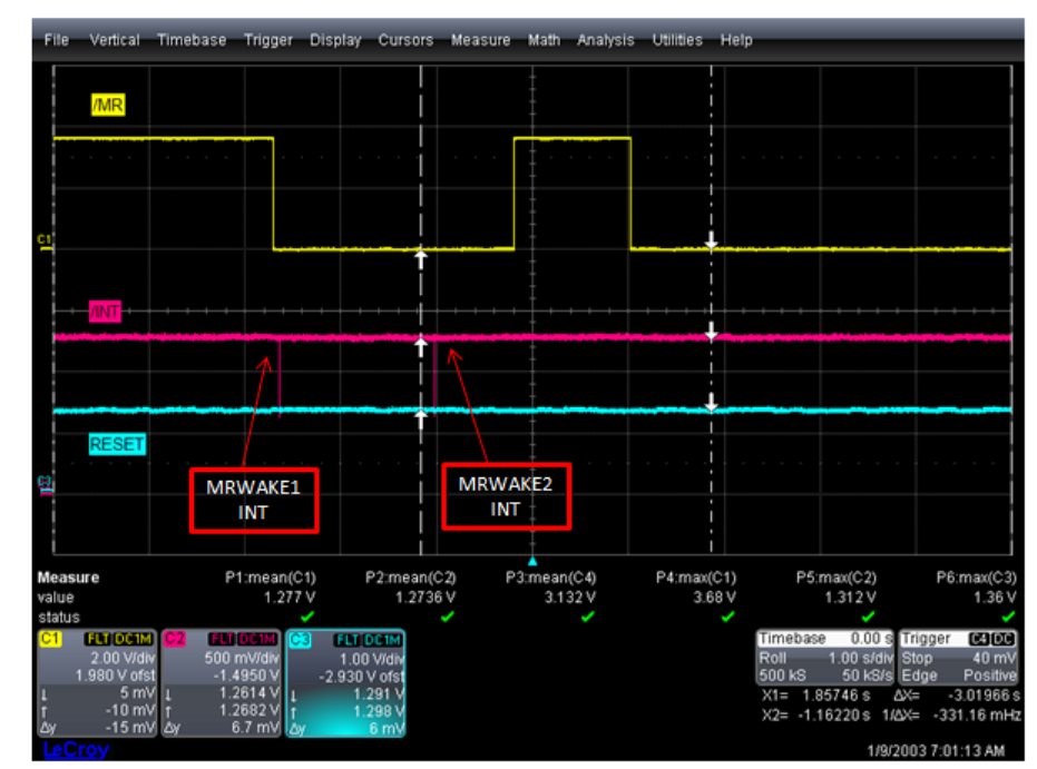

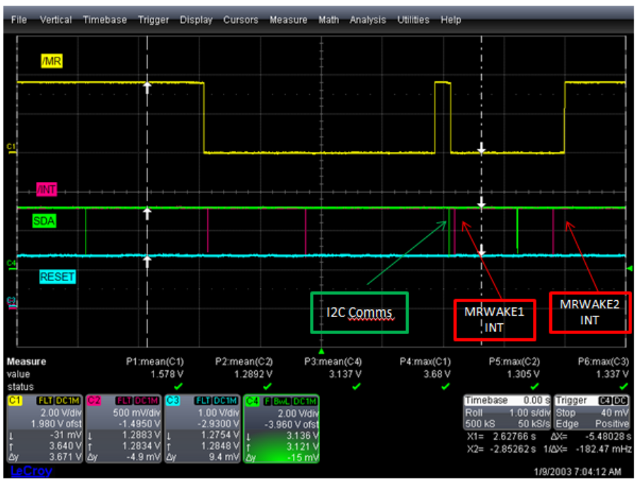

In below 2 pictures in our datasheet, when the /MR is pulled low for time longer than wake1, we can see a INT pulse.

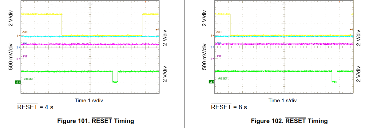

However, in below 2 pictures, when the /MR is pulled low for time longer than tRESET, there is no pulse on the INT line. Could you help explain why?

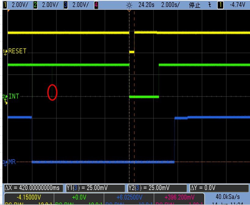

What's more, I test the waveform on my own as below waveform. When the /MR is pulled low for about 1.6s, we saw the INT pulse show up. This pulse should be caused by twake1 so this means twake1=1.6s. But according to our datasheet, the maximum twake1 is 1s. So could you also help explain on this? Thanks
