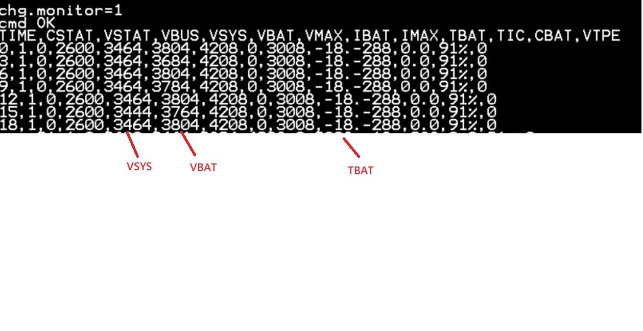

Customer is using bq25890 on their system and they found that the VBAT value read back through internal ADC is inaccuracy.
Real measure Vbat by digital meter is only 3.25V, but read back value is 3.8V.
What is the possible reason?
VBAT: read REG0E
VSYS: read REG0F
TBAT: read REG10

  • Hi Jeff,
    According to our above error log, it indicates:
    VSYS(REG0F) is 3.464V.
    VBAT(REG0E) randomly changes from 3.684V to 3.804V within 18 seconds.
    TBAT(REG10) is -18.288degC.
     None of these values are reasonable at that moment, because it was room temperature environment, and we made our device discharge.
    Here is how BQ25890 works good to us.
    VSYS is around 3.1V.
    VBAT is around 3.1V.
    TBAT is 28.85degC.
    All these values fit real ambient temp and real battery voltage.
    These abnormal values were ever found on 3 devices ( all manufactured at same sample build ). However, its quite hard to be reproduced.

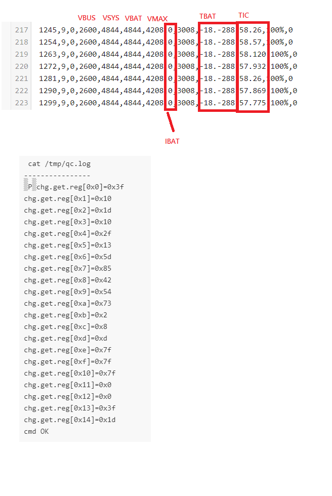

  • Hi All,
    We confronted a more weird read values from the BQ25890.
    The situation is:
    1. Chamber is controlled at 40degC.
    2. Adapter is plugged (QC2.0 standard).
    *TIC refers to on board NTC placed near BQ25890.
    Weird points I think:
    1. Adapter is plugged but REG0B shows VBUS status is "No input".
    2. VBAT is 4.844V. REG-6 register setting shows we correctly set limit to 4.208V, which refers to our VMAX value.
    3. When ADC functions becomes abnormal, TBAT ( REG10) is -18.288, no matter room temp or 40 degC chamber.
    Besides the wrong ADC values, "no input" status of VBUS will cause MCU mistakenly set VSYSMIN to 3.0V while there is a powering adapter.
    BR,
    Joseph
  • Joseph,
    1. You mentioned that the test was done without VBUS and with battery only. So "VBUS=No Input" should be correct.
    2. The BQ25890 ADC measures the ADC parameters at the pins of the device. There could be line drop between the VBAT pin and the battery pack terminals.
    3. REG0C=08 means BATOVP status. Please check the reason.
    4. REG08=42 means IRCOMP is in use. Please double check if IRCOMP resistor and IRCOMP voltage clamp are set appropriate.
    Ning.
