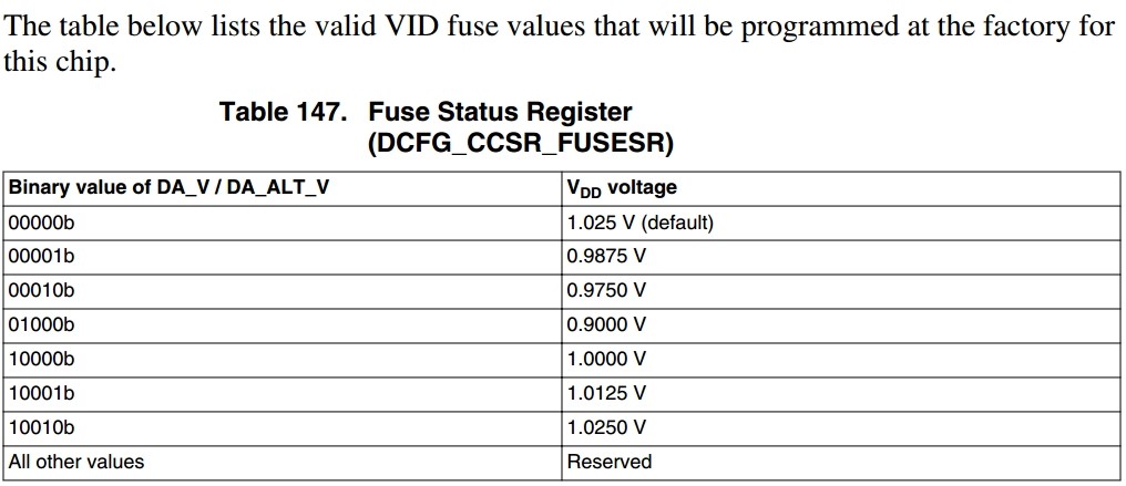

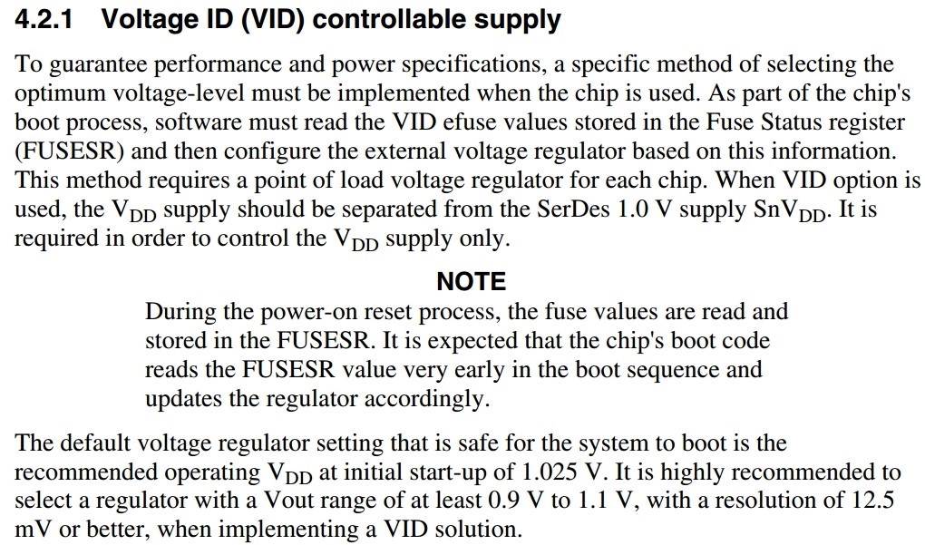

 My customer used processor is NXP LS1088A, they need a suitable VID power:
The requirement as below, please help to choose a suitable solution,thanks!
1. I2C interface for  power controller, single channel
2. Step is 12.5 mv
3. Default voltage value can be set
4. The output voltage range can be adjusted between 0.9875V and 1.025V
