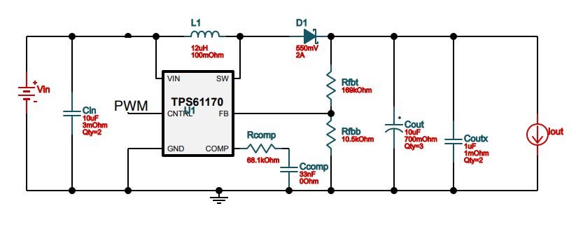

The customer is having problems with PWM of TPS61170. Please see details below:
1) PWM duty cycle = 100%, with or without load, it works fine
2) PWN = variable, without load, the output voltage changes as expected
3) PWN = variable, WITH load, everything drops out
So it seems I have the chip set up OK, the PWM is working (i've looked at oscilloscope), it just shuts down or something when I make PWM anything other than 1
(Schematic diagram attached) - generated using Webench tool. Everything is identical to this circuit, except I connected CNTRL to PWM.
