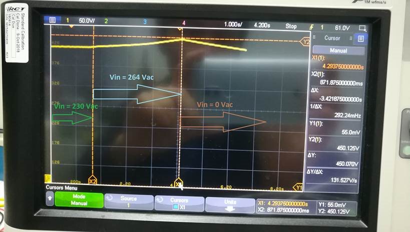

We use UCD3138 for single phase CCM PFC . output of PFC about 800W .
We found that when PSU was in 0A output load condition.
The bulk voltage was rising up like the figure below until it had tripped OVP and
happen only in quite hi-line input voltage (245 to 264 Vac) and
just found only one sample in several samples, not every samples found this problem.
Have you ever faced this problem before or do you have any suggestion about this?
Test condition of the below waveform: AC voltage turn on  with 230 Vac then switch to 264 Vac immediately then turn off AC voltage.
Thank you so much & Bestregard
Prarinya
  • This is generally caused by offset on the current sense from the external amplifier and the EADC on the UCD.
    With negative offset, a current reading of 0 will actually mean a current is still flowing.  So the firmware will request zero current, but the hardware will deliver some current.
    You can solve it by putting in maybe 10 millivolts or more of positive offset in the current amplifier so that even if there is negative offset in the system, it will be overridden by the build in positive offset.
    Another thing you can do is to put in effectively burst mode - if the output voltage gets too high, just turn the DPWM off until the output voltage drops back down.
    If its a light load issue, you will have plenty of time to do this if you sample at the 10 KHz interrupt rate.
