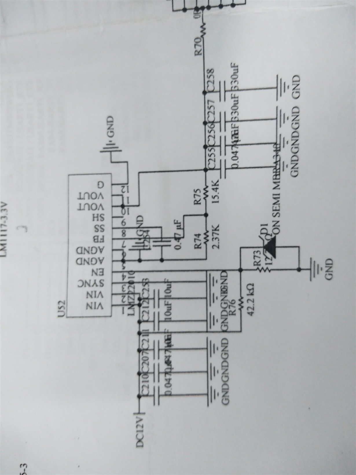

LMZ22010: LMZ22010 SYNC grounding PWM Fixed stray
Part Number: LMZ22010
Here is my Schematic diagram
    Is there a specific question that you have regarding the LMZ22010 power module?
    In the mean time, listed below are my comments of the schematic review:
    • Minimum recommended input capacitance of 30uF (√)
    • Recommended output capacitor combination of 2 x 330uF with a 47uF (√)
    • AGND externally connected to PGND(EP) (√)
    • Regulated output voltage
      • VOUT = 0.795 x ( 1 + 15.4k/2.37k) = ~6V
    • Enable divider
      • Vin_uvlo = ((42.2k/12.7k)+1)*1.274 = 5.5V (follows typical application in datasheet)
