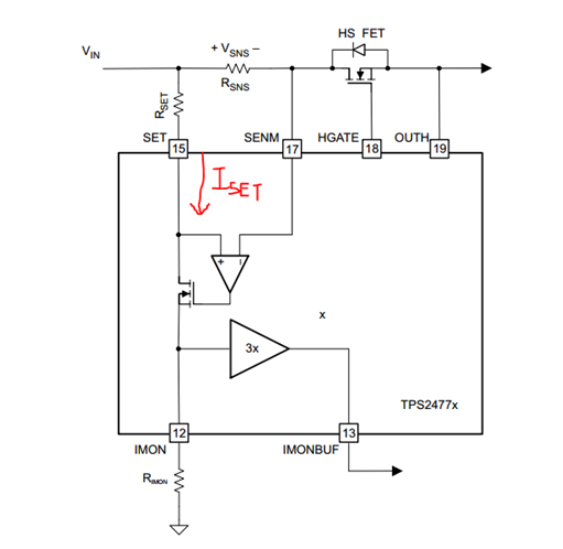

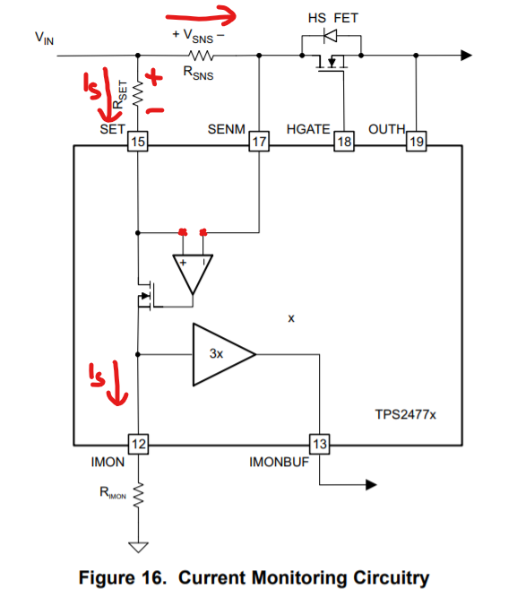

Hello Sir,

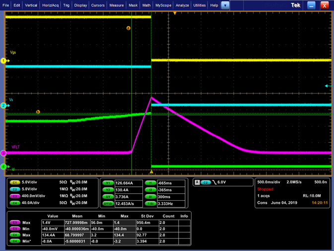

OCP is set to 100A, but test results is 130A, when current is 100A, test shows VRsns=25mV, VRset=20.23mV, Rimon=546mV,
Test condition is wait for output is stable, then increase the load slowly, up to 130A then MOSFET shut down
what’s the problem?
Rsns=0.25mOhm Rset=100ohm Rimon=1700ohm Rfstp=330ohm Cfst=1nF
