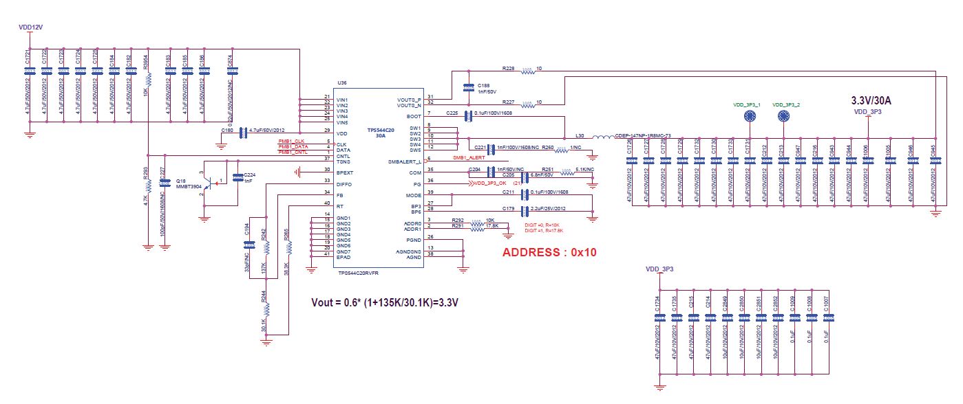

Hi TI experts,
I have designed the power board with TPS544C20. I refer to webench tool.
https://webench.ti.com/power-designer/switching-regulator/customize/752?AppType=None&O1I=30.0&O1V=3.3&VinMax=12&VinMin=12&base_pn=TPS544C20&lang_chosen=en_US&op_TA=30&optfactor=3&origin=ti_search&refpage=http:%2F%2Fwww.ti.com%2Fsitesearch%2Fdocs%2Funiversalsearch.tsp
Input: 12Vdc, Output: 3.3V/30A
It is working well with 700nH inductance. But when I changed to 1.8uH, it is not working. no switching, no output.
Could you explain the reason?
Inductor part No.
700nH: CDEP-147NP-0R7MC-95 (sumida)
1.8uH: CDEP-147NP-1R8MC-73
And I have a audible noise issue with 700nH inductor. Do you have any debugging point?
  • Mason Noh said:
    Part Number: TPS544C20
    Hi TI experts,
    It is working well with 700nH inductance. But when I changed to 1.8uH, it is not working. no switching, no output. A higher inductance value means  a lower cutoff frequency of the LC filter leading to a lower bandwidth. Too low a bandwidth can cause issues with startup. Try re-calculating the compensation network values to keep the loop in the stable region.
    Inductor part No.
    And I have a audible noise issue with 700nH inductor. Do you have any debugging point? Your IC is running into Hiccup Mode. In Hiccup mode, your effective switching frequency becomes low enough to lie in the audible region and is causing you trouble.
