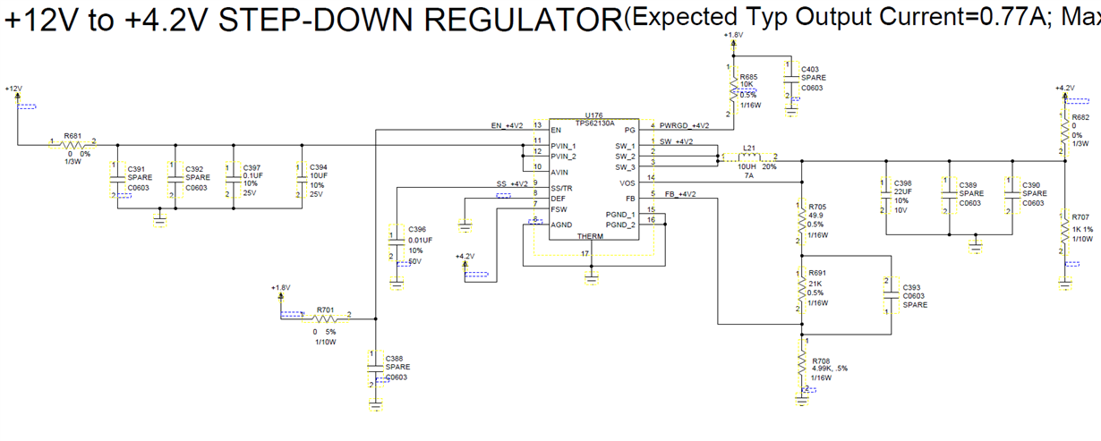

I am designing TPS62130 with switching frequency of 1.25MHz, Vout =4.2V. FSW is tied to Vout in this case. I noticed there is a large overhoot during the start up. The positive overshoot reaches +6.2V. Is there any design issue that can cause such behavior? The SS pin is tied to 0.01uF. Thanks
    Can you provide the schematic you are using for your application as well as a scope shot of the behavior you are seeing?
    What are exactly the operating conditions of your system? (Vin and Load)

  • Operating condition: Vin=+12V, Test Load=0.1A & 1A
    My Schematic:

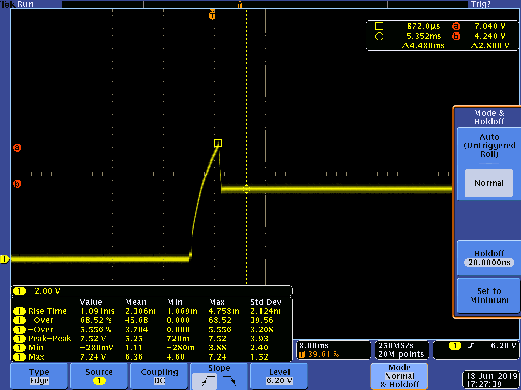

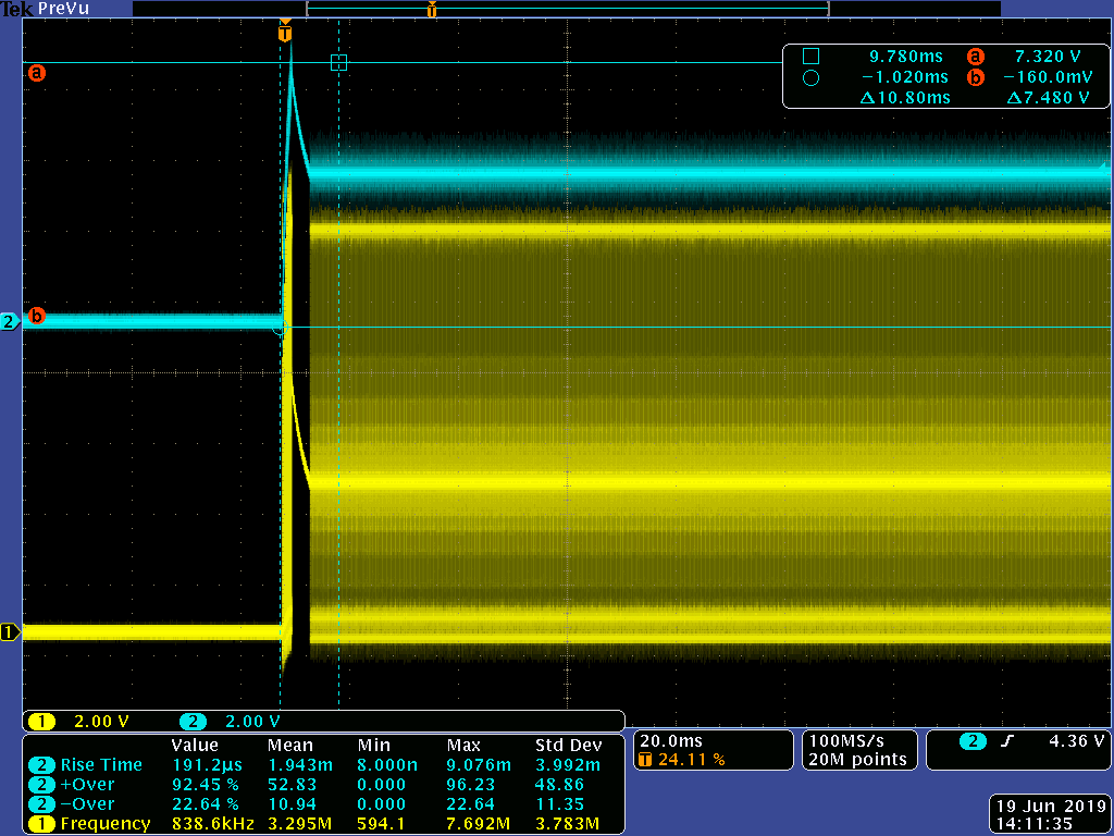

    My oscilloscope result when measuring rise time and overshoot at output:

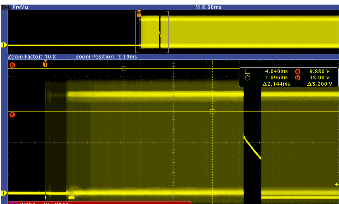

    Weird waveform at switching node:
    My thought is that when the output voltage is insufficient / havent output 4.2V, FSW=2.5MHz? Until the point where 4.2V or desired output reached, FSW=1.25MHz.  But not sure why interval there is a weird pattern retrieved as shown in picture. Is there sth wrong in my design?

    If you see the width of that overshoot, it's roughly 5ms which is also equal to the soft start time set by the timing cap Css.
    Try reducing the value of Css or simply remove it and check.

    I did suspect on SS/TR so i also try to reduce to 3900pF. The waveform obtained seems like it still 5ms overshoot time.
    Yellow; Switching node, Blue: Output voltage during start-up
    Before we have to go further in any investigations. I think it is essential that your FSW pin is tied to a constant value and not VOUT which goes from logic state low to a logic state high. If you could apply either VIN or a voltage greater than 0.65V on FSW it would really helpful.

    Sorry for late reply. I have fixed the issue. There is nothing related with the design for the overshoot issue. We are suspecting we turn on the enable first before the Vin is come in, after trying a few time in such way, the IC get burn. We have try rework and power up with Vin come before EN, there is no overshoot issue appear. Thanks for helping to fix the issue.
