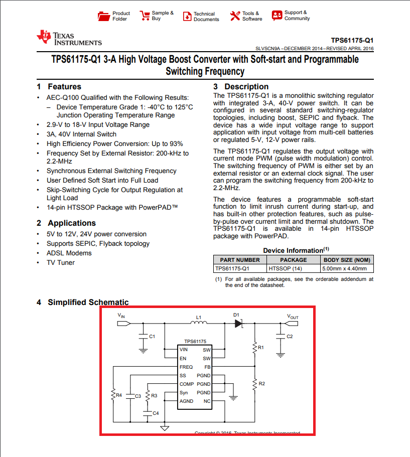

Dear TI Team
Here are my 2 questions for TPS61175Q1 IC.
1. What is the value of the resistor and capacitor to be connected in series with COMP (pin 8)?
2. What is the PCB Layout footprint dimension of this IC.
