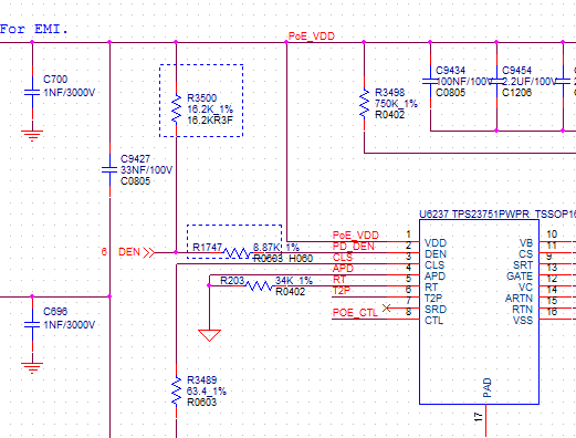

My customer use TPS23751 and use types of option 3 oring techniques on their design,
but when I review their circuit, their Rden1 & Rden2 didn't follow below design, they use RDEN1 16.2K & RDEN2 8.87K it were cause any risk?

Hi Allen,
the 13k ohm is important. Note the PSE MUST reject anything lower than 15k. So you want to be below 15k ohms. However, if too low, then the power dissipation gets higher and the resistor power rating must increase. I recommend sticking with the solution we recommended. Note the 1/4W 13.7k ohms resistor is important. Thanks!
Hi Allen,
Just to clarify, yes the hotswap will disable and PSE will remove power. However, after PSE power removal, the PSE may try detection to see if PD is connected. When this happens, you want the PSE to reject the PD and not try to turn back on. This is why we choose lower than 15k since per the standard the PSE must reject this detection resistance and the PSE indeed doesn't try to re-power the PD when the adapter is connected.
Thanks!
Hi Darwin
Thank you for your quick reply. I fully understand.
Thanks a lot.
