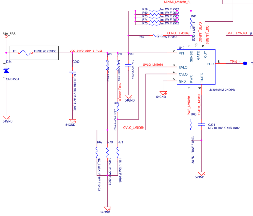

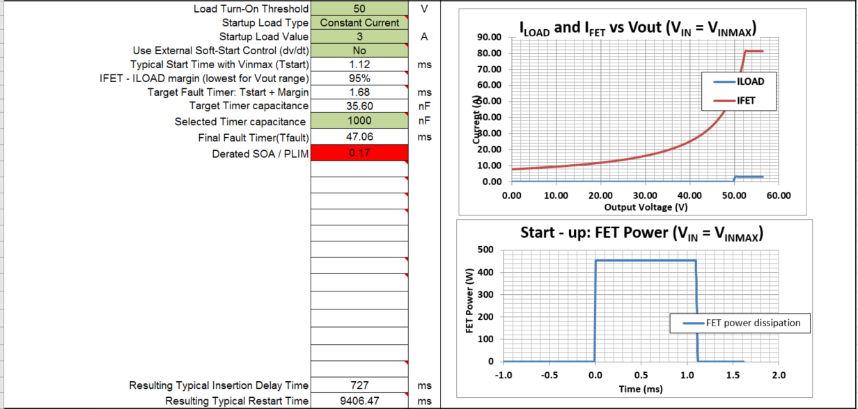

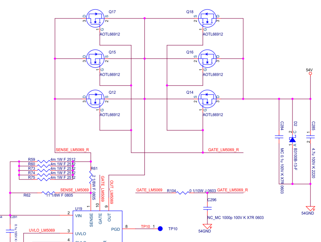

Hi Sirs,
We use LM5069 and use document "LM5069_Design_Calculator_REV_C" to calculate,but it's show high risk. can you give me some suggestions?
please see the below for SCH and design tool figure
sch
Design tool
