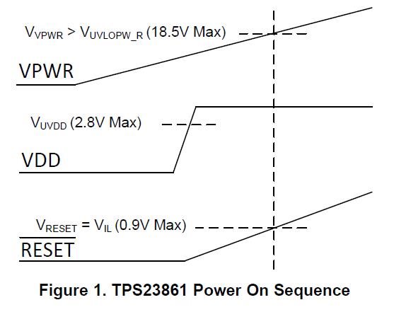

Hi Team
The power sequence in the TI document (SLVA723) is shown below.
If not following the above sequence, can the product be damaged?

Charles, Yes it can. It is important to guide the end customer to follow this power up sequence. The device datasheet also has this warning in a few locations.

Dear Thomas
If I do not match the power sequence, could it happen burnt VDD or VPWR of TPS23861?

Charles, At this point, it is better to hand you over to the PSE Application Engineer. Penny is the expert on what could go wrong with the IC if proper power up sequence is not followed.
Hi Charles,
If you don't follow the power on sequence, VDD or VPWR will not be burnt but the device will not be full functional. You could see the device doesn't turn on the port or the class current measurement is not accurate. So it is very important to follow the power on sequence described in the app note. Thanks.
