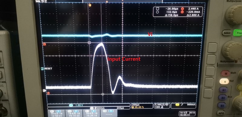

When the output load suddenly increased,the input current will inreased too, but why find nagative current ? nearly - 200mA

Hi Fandy,
I am not seeing any negative current with load step. For boost circuit, input current should be same as inductor current. Is that where you are measuring? Can you please tell me your measurement conditions like Vin, Vout (Vvs), load step so that I can verify under your conditions as well? You might as well tell me VGH/VGL voltage levels also.
