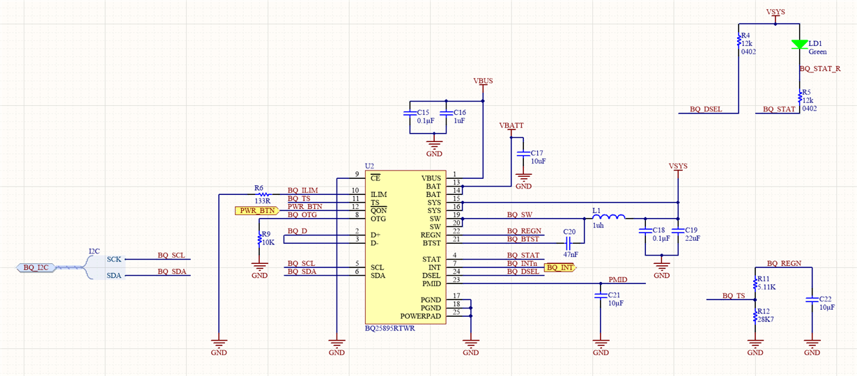

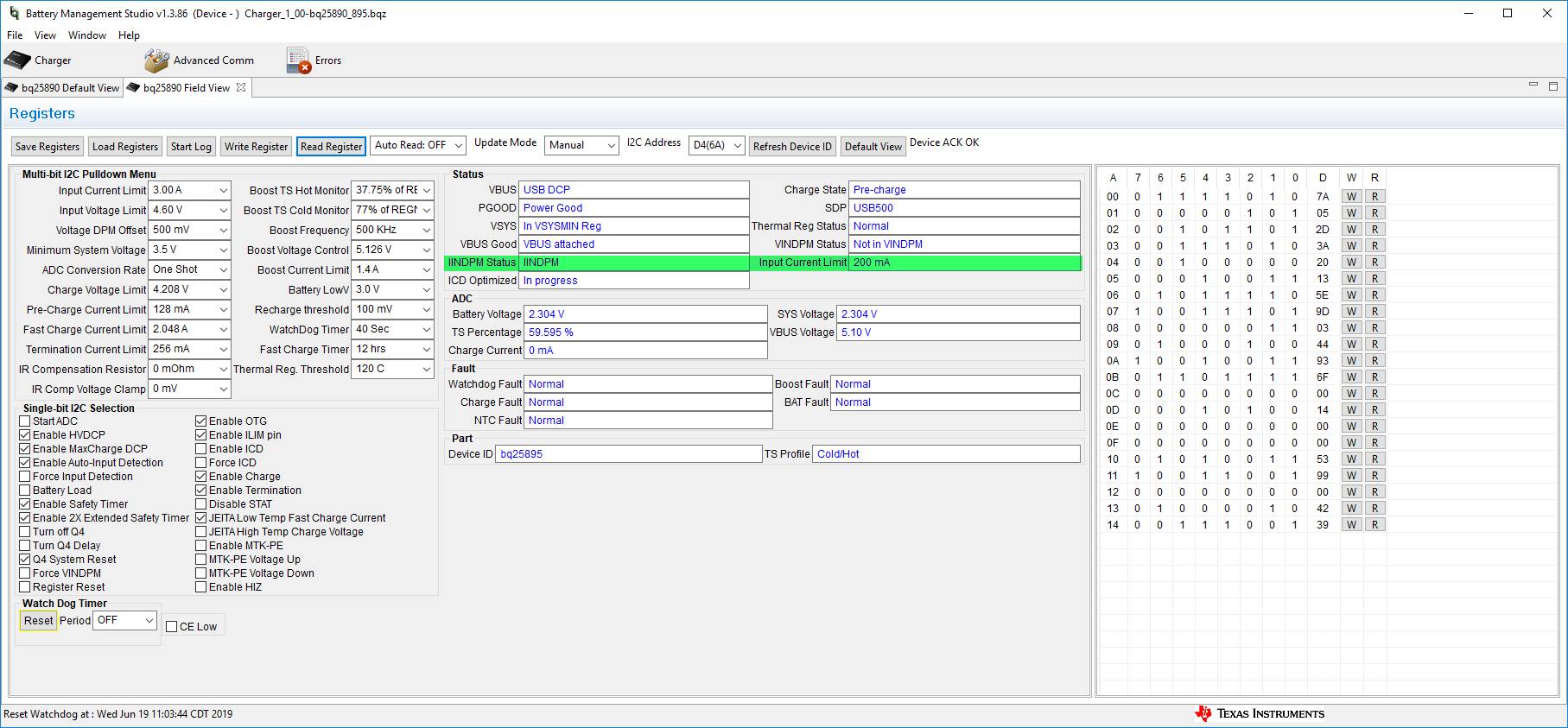

We are using the BQ25895 in our product but only get 0.6V on Vsys with or without battery inserted. Board is powered by a non standard 5V 3A supply. We are using BQ Studio to read/write registers in the device since our host MCU can not start without Vsys, but the battery charger still limits Vsys.
Schematic excerpt below
Screen cap of BQ Studio
* Created: Wed Jun 19 14:40:20 CDT 2019
* Format: Register Name  tab Character,\t  Hexadecimal register value.
* BQZ Container: Charger_1_00-bq25890_895.bqz
Input Current Limit, HIZ and ILIM pin	7A
OTG Temperature thresholds, and Input Voltage DPM Offset	05
ADC controls, OTG Frequency, ICO, DCP, and Input Detection	3D
Battery Load, WDT Reset periods, OTG and Charge Enable, and MINSYS setting	3A
Fast Charge Current Limit settings and MTK Pump enable	20
Pre-charge and Termination Current Limit settings	13
Charge Voltage Regulation Limit, Battery Low Voltage and Recharge threshold	5E
Termination Current Enable, STAT pin, WDT, Safety Timer, and JEITA Charge Current	8D
IR Compensation and Thermal Regulation thresholds	03
ICO, Extended Safety Timer, BATFET control, MTK Pump Voltage, and JEITA Charge Voltage	44
OTG Regulation Voltage and Current Limit settings	90
Charger VBUS, Charging Mode, PG, USB Input, and System Voltage Regulation status	6F
WDT, OTG/VBUS OVP, Thermal Shutdown, Safety Timer, and TS pin faults	00
Input Voltage DPM settings	14
Thermal Regulation Charge Status, and ADC Battery Voltage conversion	00
ADC System Voltage conversion	00
ADC TS pin voltage as percentage of REGN conversion	00
VBUS status, and ADC VBUS Voltage conversion	99
ADC Charge Current conversion	00
DPM status, and Input Current Limit setting	42
Registers reset, Input Current Optimizer status, Device ID, and Temperature Profile	39
Are we missing some other register configurations to bring Vsys up?
