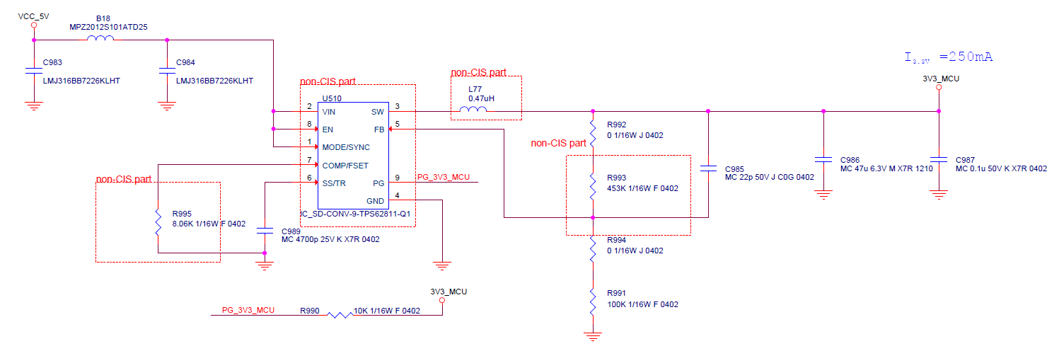

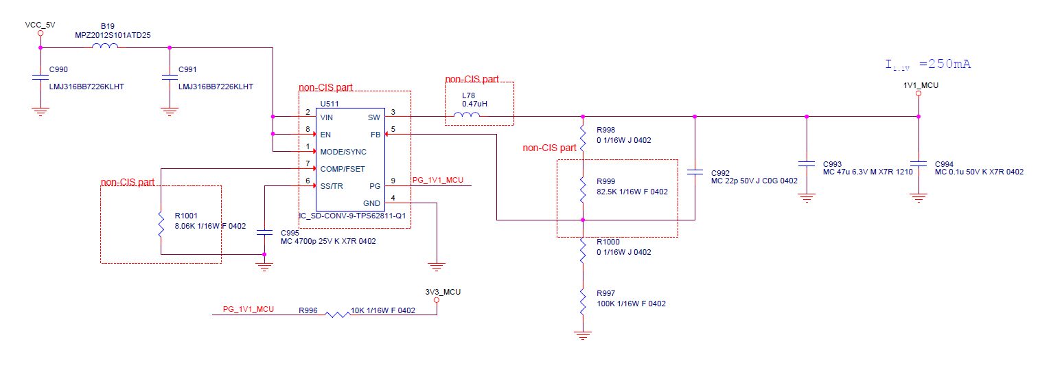

Dear Team,
Here is the schematic, can you help on final review it?
BR
Kevin

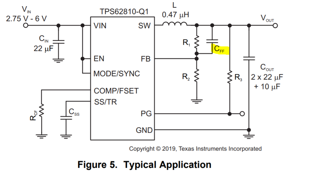

The schematic basically follows datasheet recommendations, so it should be ok. You may need to adjust the value of the feedforward capacitors. The latest version of the datasheet recommends 10pF for lower resistor values in the feedback divider.
