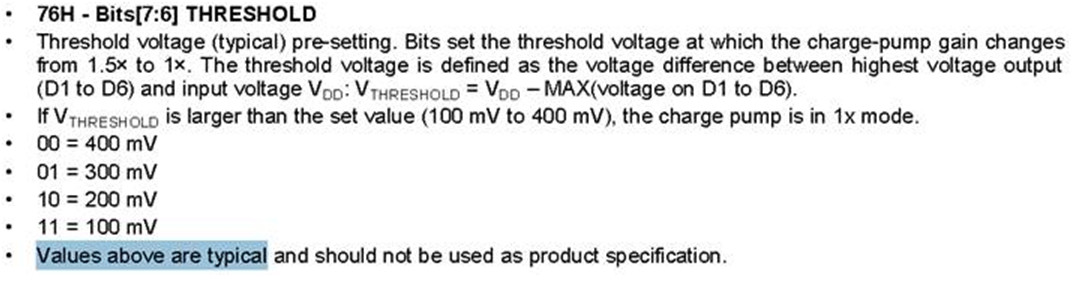

Hi Team,
Could you help to confirm the tolerance of 76H threshold.
Since we found the tolerance from 1x to 1.5x is different with 1.5x to 1x as we set 400mV.
We know the value are typical, but is there reference tolerance?
Hi Team,
Unfortunately we don't have the tolerance for this threshold.
Cusotmer can adjust the threshold level based on their applications.
