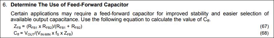

2. Cff= VOUT / (VIN-MIN x fS x ZFB)
Vout = 4.2V
Vin min = 9
Fs = 500KHz
Rfbt;73.2K
Rfbb :10K
therefore, Cff= 106 pF
While on webench the value of Cff shows to be about 330pF. Why ?

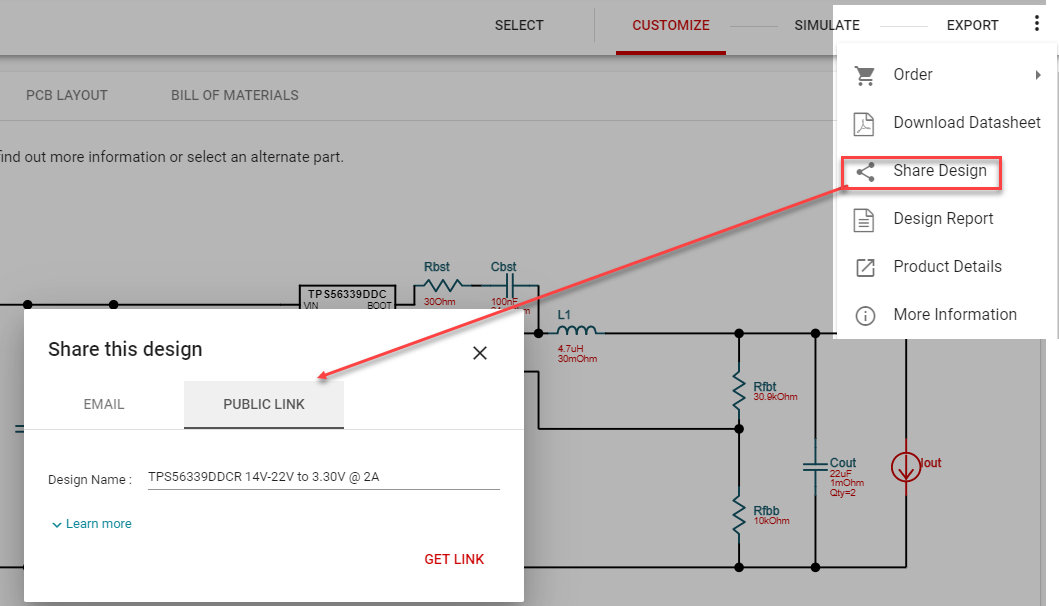

    Would it be possible to share your WEBENCH design using public link option (see screenshot below for reference)? This will help us check calculations for your conditions.
    Amod
  • Hi Amod,
    Please find below the public link of the design.
    https://webench.ti.com/appinfo/webench/scripts/SDP.cgi?ID=1C02BC96AFF3D30B

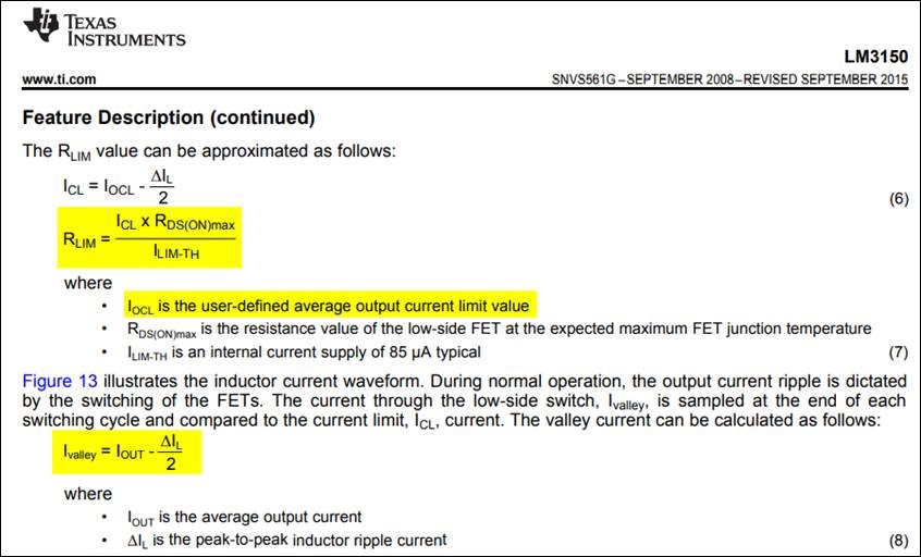

    1. Rlim: Below is the snapshot of data-sheet for Rlim selection
    Below are the breakup for calculations
    a. Iocl = 1.2 * Iout (20% margin)
           = 1.2 * 8 = 9.6A
    b. Delta IL can be calculated using below equation
         ((VinMax - Vout ) ∗ Vout)/(Fsw ∗ L ∗ VinMax )
          From your shared design, VinMax = 24.2V, Vout = 5V, Fsw = 486KHz and L (Inductor) = 3.3uH
          Delta IL = 2.47A
    c. Hence Icl can be calculated using equ (6) from data-sheet (see above image)
         Icl = 8.775A
     d. Finally Rlim can be calculated using equ (7)
          i. One thing to note here is WEBENCH uses accurate Rdson of selected Low side MOSFET based on its junction temperature.
               From your shared design, CSD18531Q5A is getting selected as Low side MOSFET. For now you can use 7.4mohm for your calculation.
               This value will change if the MOSFET selected is different.
          ii. Ilim-th is considered as 75uA based on electrical characteristic table (Pg No 5 from data-sheet under Soft-Start section)
    Rlim comes out to be around 866ohm for your shared design.
    2. Cff can be calculated using below equations.
    From your shared design, VinMin = 7V, Vout = 5V, Fsw = 486KHz, Rfb1 = 73.2Kohm and Rfb2 = 10Kohm.
    Cff comes out to be around 167pF for your shared design.
