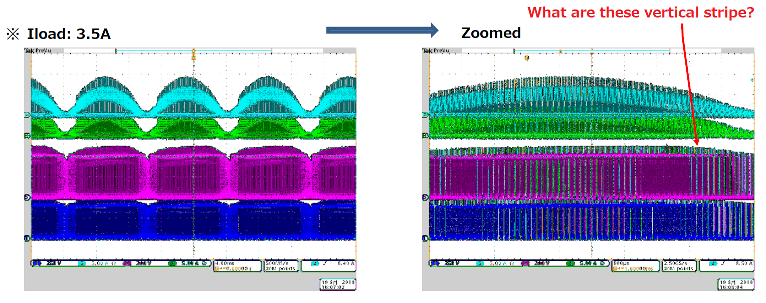

One customer is designing UCC28070 on 2.3kW (390V / 5.9A) function.
※Input is 200Vac
But problem is occurring, Vds ringing is large.
My question is two points below, please let me know any advice;
①When load current increase to "0A → 0.5A → 1A → --- → 5.9A" and measure by oscilloscope, waveform is conspicuous vertical stripe.
 What is the reason of below vertical stripe?
②When timing for duty cycle exceed 50% (Less than 50% → 50%), large VDS ringing is occur and larger current become more large VDS ringing.
 ※In the case of "over 50% → less than 50%" is no problem.
 Please let me know about the reason of increase VDS ringing by over 50% duty.
  And, is there any idea for reduce ringing?
Satoshi
  • Hello Satoshi-san
    The 'Vertical stripes' are almost certainly an artifact caused by the 'scope screen resolution. One way to check this would be to split the screen and look at one of the stripes using the zoom function.
    The ringing at 50% duty cycle is probably due to some interaction between the turn-off of one MOSFET and the turn-on of the other. The PCB layout may have an effect on this but I really couldn't give any specific advice without seeing the PCB Gerber files.

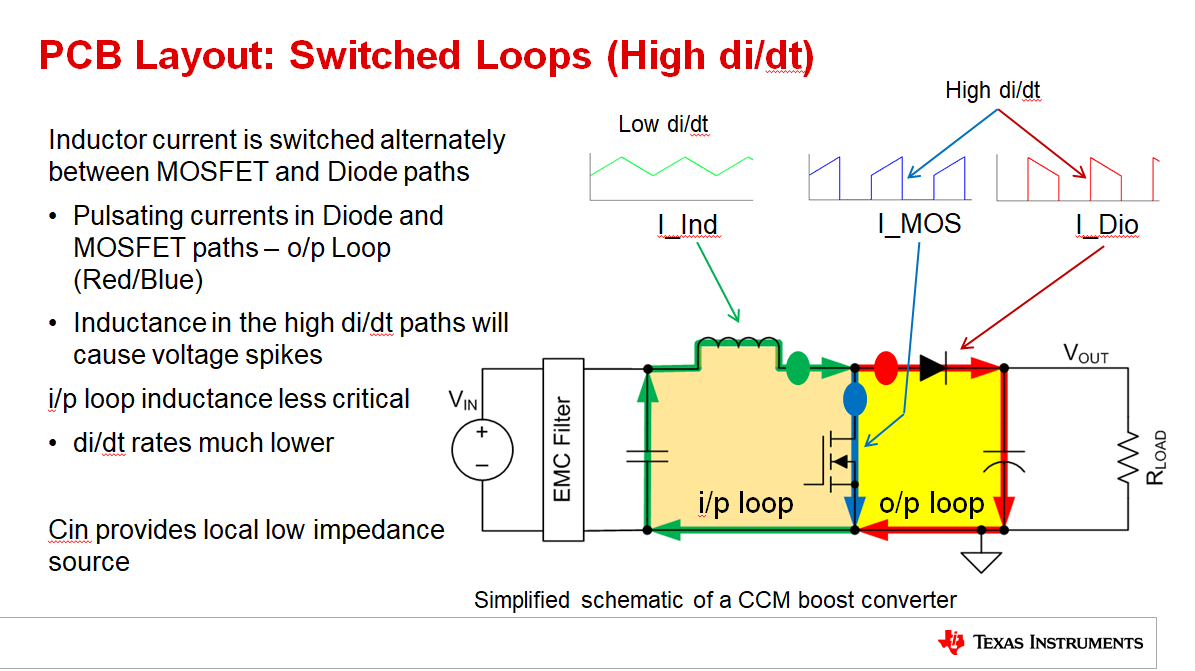

    If the interference is happening only at the 50% duty cycle point then I would strongly suspect that there is an issue with the layout. The customer comment that "GND reference is tied Cout negative side (EL capacitor) of 380V output side and Each MOSFET's(source) are tied GND of AC input side." means that any inductance in the path from Cout Negative to MOSFET source will develop a voltage as the current is switched on and off. There is a PCB layout video at https://training.ti.com/pcb-layout-smps-part-1-2?cu=1134585. At about 7min 30s into the video there is a slide showing the switched current flowing in the O/P loop. Any stray inductance in this path will generate voltages as the current is turned on and off and the inductance of the input and output loops should be minimised.
    Any PCB related ringing  should be present on both the first half and second half of the line voltage sine wave and I don't know why that would be.
    The output output capacitor will prevent the output voltage of the PFC stage from increasing.

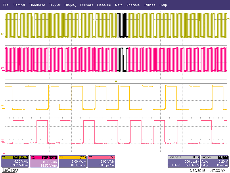

    Satoshi
  • Hello Satoshi-san
    Here it is - please let me know if it is not visible. I can see it right now as I type but I can never be sure that what I see is what gets posted.
    Colin
