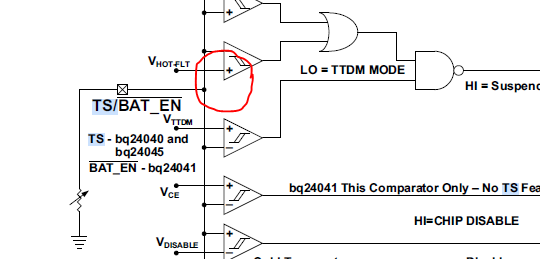

Does BQ24045 have a internal(means inside the silicon) pull up resistor on TS pin? If yes, what's the accuracy?

The TS pin has an internal current source to bias the external NTC, 50uA. No pull up or pull down.
Also the pin has additional function, see below FAQ
