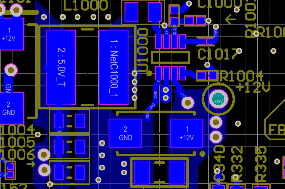

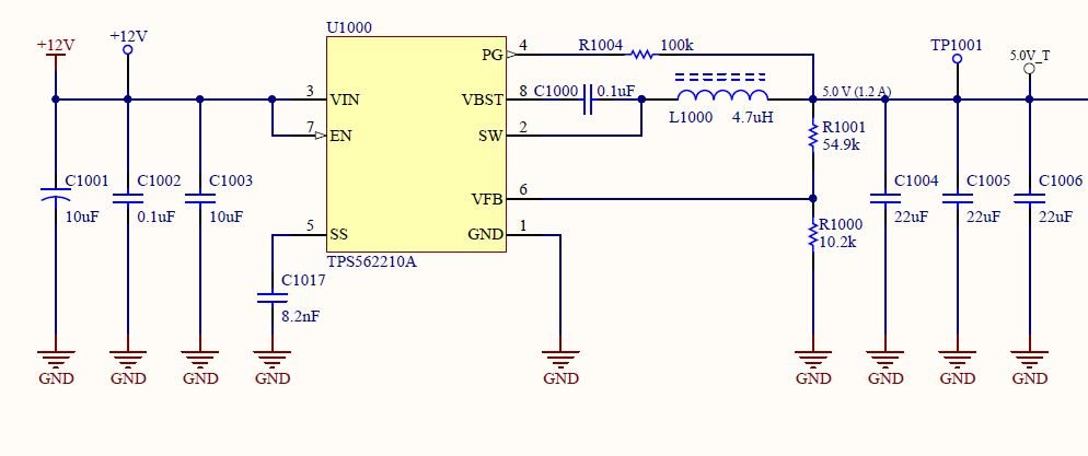

I used the circuit similar to the EVB, to get 5V output voltage, with input voltage 12V. I measured the output voltage on this to be 1V.
When I try to probe near the VFB resistor (R1000) - just by touching I see a 4.9V output. It observed in all boards. Not sure what is causing this erratic behavior ?
Attached are the schematics and board layout.
I would appreciate your help in this regard.
Venu
  • Hi Venu,
    Did you capture the waveform on SW and is there any other caps on the 5V besides the 66uF showed in the schematic? It is possible that the device is overcurrent and enter into hiccup mode. One way you could try is to increase the value of C1017 to longer the soft start time to avoid the overcurrent protection during soft start.

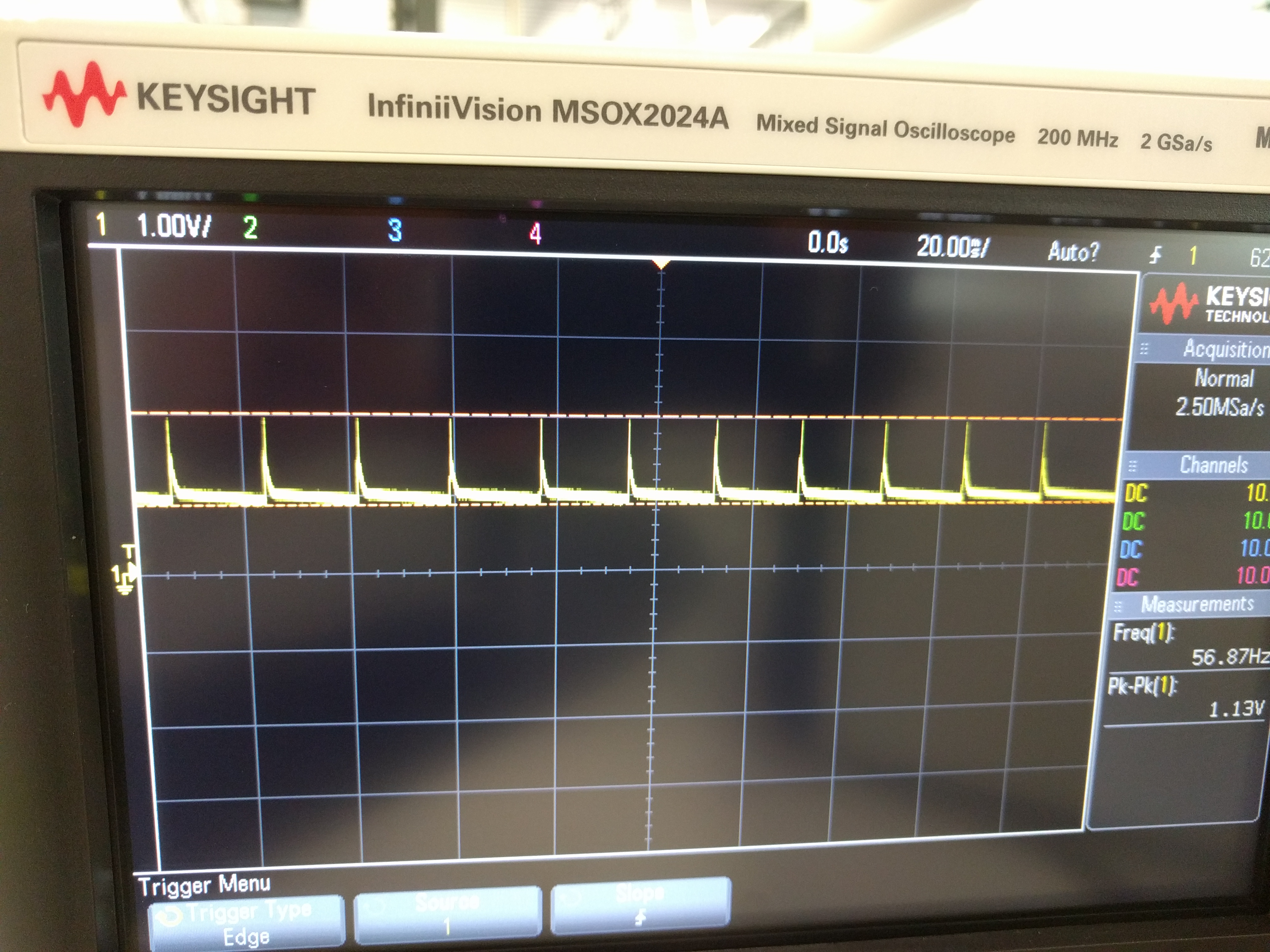

  • Hi Anthony
    Attached is the waveform, when it is powered up.
  • Hi Venu,
    From your waveform, the device is OC protected and is working under hiccup mode. The device is keeping trying auto restart.
    Two way to solve this:
    1. Remove C1005 or remove C1005 and 1006 both and try start up again
    2. Enlarge the value of C1017. It will only affect the soft start time and will not impact the output ripple. Thanks!
  • Hi Anthony
    I have checked removing the C1005, C1006. It didnot resolve the issue. The same with the C1017, it didnot effect the output voltage. You are right, the device is over current protected mode.

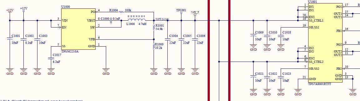

    Just to let you know, to see if it issue, I fed the output of this regulator to two LDO regulators (1Dual LDO , 1 single LDO).
    1. Dual LDO is TPS7A880 (Attached is the schematics)
    2. Single output LDO is TPS7A4700RGWR is similar with 10uF and 10uF input capacitor
    Venu

    I have two such devices on board, one device works perfectly with no issues (1. TPS562210A followed by LP38798SD, got the expected voltage). The other one with TPS562210A followed by 2 regulators doesn't.  The layout exactly same for both devices.
    The following is the waveform at VBST pin for the faulty device.
    Venu
  • Hi Venu,
    If so, the only idea I have left is that your LDO draw too much current at start up. I checked your dual channel and single channel LDO and I found they could output more than 3A current without overcurrent. If adding up the charging current to TPS562210A ouput cap, the device will indeed get into overcurrent protection. The other way to try is to switch TPS562210A to TPS563210A. You will get a higher current limit Thanks!
