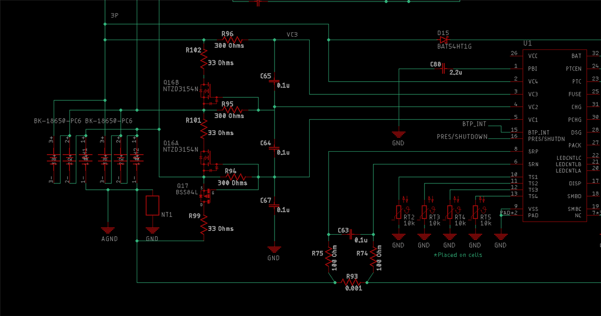

designing a 3S2P external fet balancing solution, I have a couple of questions.
where do I need to connect VC4? Do I connect it directly at the positive terminal of cell 3 or do I connect it directly to the VC3 pin?
