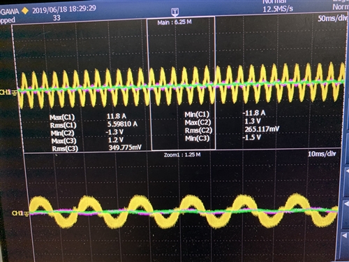

We have encountered one issue on the UCC28180 which was used in our production at our lab. The PF value became very low and the waveform was distorted.
The distorted waveform:
The normal waveform:
From the Gate PWM output waveform, we can see the abnormal performance on the position of the distorted waveform. Could you give us some possible failure reason. Thanks!

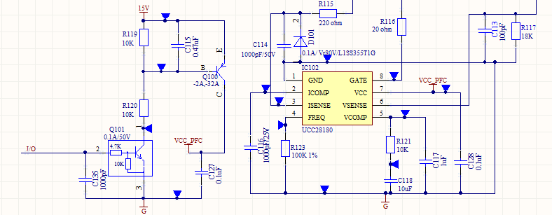

Follow is the sch:
    What were the test conditions when you captured this waveform and what is the design specification for your requirements?
    Did you use the Excel calculator ?
    If so can you please attach the results ?
    John
  • The test condition is : normal operating  with the power about 3KW.  The load is  BLDC motor.
    I did use the calculator. Please check it as below:
    INPUT:
    Minimum Input Voltage from AC Line: VACIN(min) 176 VRMS
    Maximum Input Voltage from AC Line: VACIN(max) 265 VRMS
    Minimum Line Frequency: fLINE(min): 47 Hz
    Maximum Line Frequency: fLINE(max): 63 Hz
    Minimum Rectified AC Line Voltage: VIN_PEAK(min) 248.902 V
    Maximum Rectified AC Line Voltage: VIN_PEAK(max) 374.767 V
    OUTPUT:
    Maximum Output Power of PFC Stage: POUT(max) 6000 W
    Output Voltage (Note: Must be > VIN_RECTIFIED(max)): VOUT 375 V
    Target Power Factor, VIN(nom), Full Load: PF 0.99
    Predicted Efficiency: h 0.9
    Maximum Ambient Temperature: TAMB(max) 50 °C
    Maximum Average Output Current of PFC Stage: IOUT 16.000 A
    Desired Switching Frequency: fSW(target) 22 kHz
    Recommended Resistor value on FREQ to Set the Switching Frequency, fSW: RFREQ(recommended) 105.000 kΩ
    Actual Value For RFREQ Used:  RFREQ = 100

    Recommended Input Capacitor Value: CIN(recommended) 4.700 mF
    Actual Value of Input Capacitor Used: CIN 0.330 µF

    DO NOT PROCEED UNTIL RFB2 IS DECREASED SO MINIMUM OUTPUT VOLTAGE > MAXIMUM RECTIFIED INPUT VOLTAGE

  • Please test your circuit with a resistive load.
    It may be that your BLDC load is non-linear and causing the strange waveform on the input.
    What were the test conditions for your so-called "normal"  and "distorted" waveforms ?
    John
