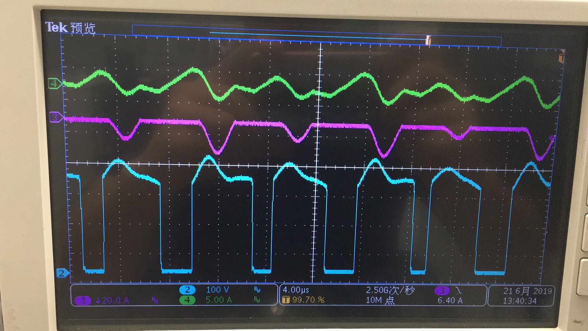

Blue: lower Vds; red: secondary winding current; green: primary winding current

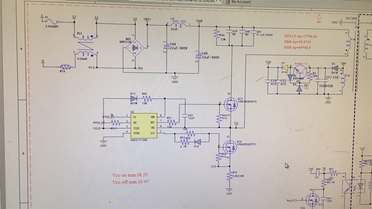

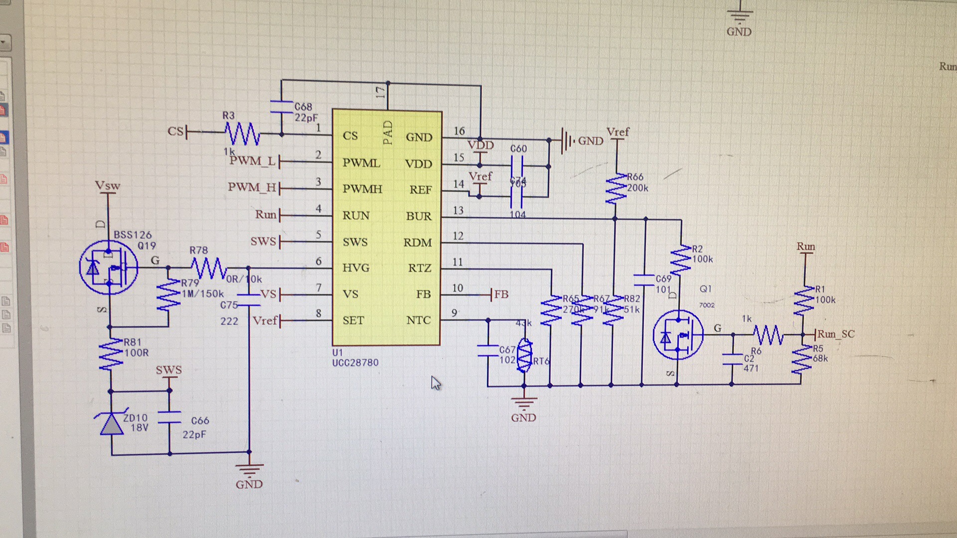

Vin=230Vdc,Vo=16.5V,Io=0.5A
Transformer turn ratio: primary side: secondary side: auxiliary winding = 20:3:10

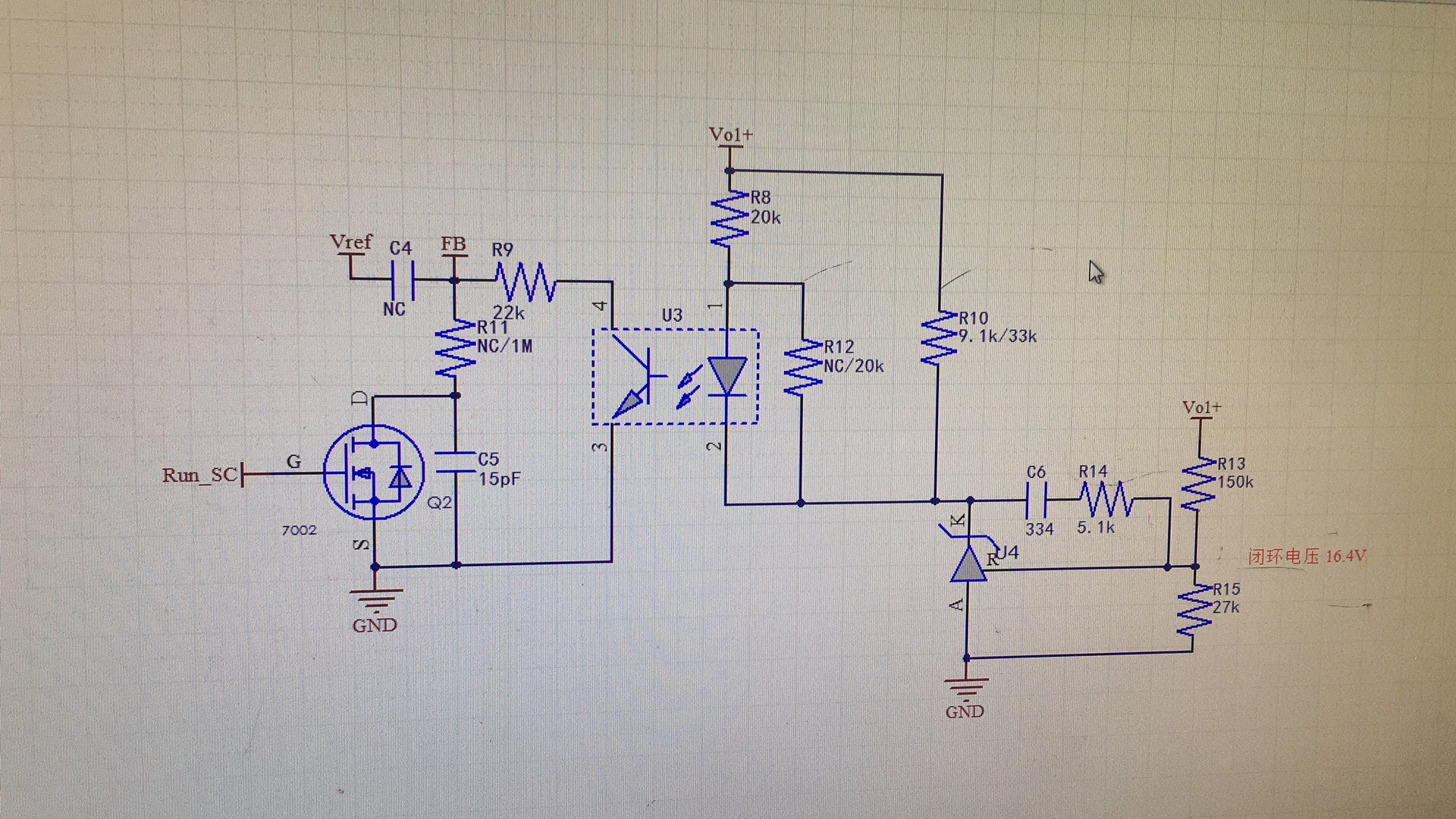

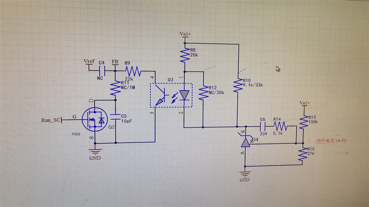

How to Set Parameters R8?than you

It looks like the on time of Q16 is changing cycle to cycle. Are you able to measure the loop response of your converter? Perhaps it is not stable.
Section 8.2.2.7 of the UCC28780 datasheet provides guidance for setting up the compensation network including R8.
