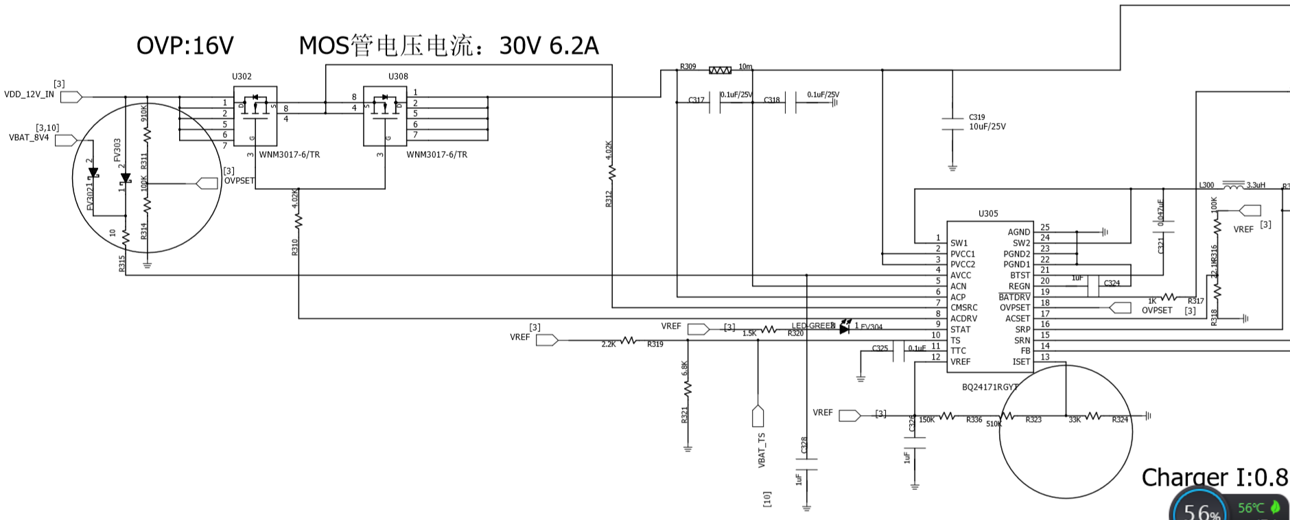

Hi:
The product I designed USES BQ24171.In the debugging process, when the OVPSET voltage is 3.2v, the chip can still work, the OVPSET is not off, and the range described by Vacov in Datasheet is 1.57 (Min) -1.63(Max).Please give me some guidance. Thank you.
My schematic is as follows:
