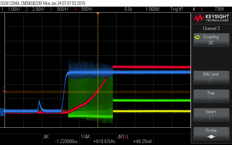

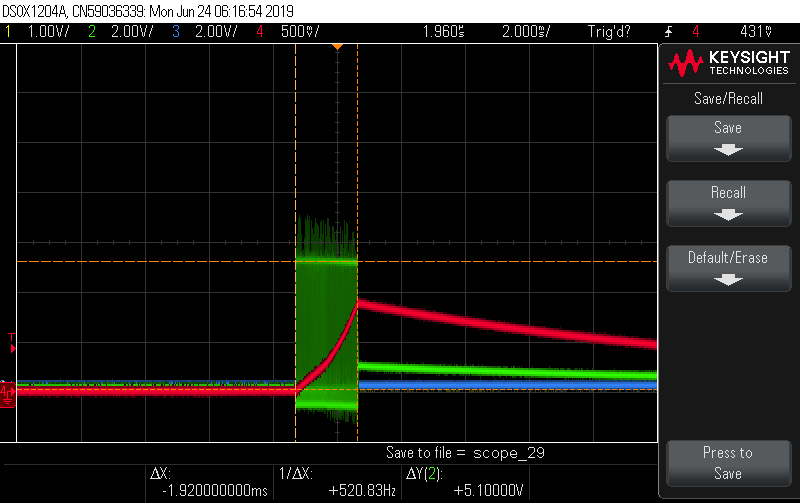

I have three boards from the same batch that implement the application circuit from the datasheet to power two DDR3L chips (1.35V). One of the boards can power-up and has a seemingly stable output. The other two boards fail to stabilize and appear to latch into either the OVP or UVP state, depending on how much load capacitance. In one case the output goes up to 1.5V before it shuts off. Here is a plot that shows the SW (green) and VDDQ (red). After 2ms from the start of SMPS operation, the output fails to reach REFIN (1.35V) and latches off.
On this one the load capacitance is reduced by 20uF, but then the output voltage goes over 1.35V and again the switching stops. One observation is that the SW output doesn't go to zero, which should happen according to datasheet after an OVP fault: "When an OV event is detected, the controller latches DRVH low and DRVL high."
Red = VDDQ
Blue = REFIN
Green = SW

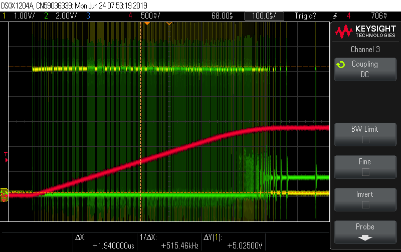

Here is a view of the board that is able to regulate:
Some observations:
1. The failing boards have the oddly shaped VDDQ waveform that looks a power function instead of a linear or negative exponential. The 'good' board has a linear ramp.
2. The switching frequency is all over the place. The failing boards are pretty consistently hammering the FETs at about 600kHz. Much higher than I imagined since it's set for 400kHz. The 'good' board even has some pulses that are in the MHz range. Is that normal at startup or should it really be no faster than 400kHz all the time (except in light-load)?
3. The 'good' board appears to throttle back on the pulses, while the failing boards have a very constant frequency (even though it's way too fast) up until it latches off from OVP or UVP. Why isn't the chip seeing the high voltage and throttling back?
Is this a stability issue?

    The problem with slowing down the circuit any further is that this chip allows ~2ms from SMPS operation to OVP / UVP detection function enabling. When I reduced the load capacitance by removing the extra 10uF ceramic capacitor at the load, VDDQ ramped faster but then the IC started going into OVP (got up to ~1.5V when design is set for 1.35V). If I add more capacitance I imagine the ramp will be even slower and we'll continue to go into UVP.

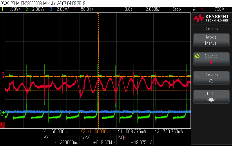

    Since this is a DCAP design, what is the behavior if there isn't enough ripple? The ripple does not look like figure 35 of the datasheet, it looks more like an oscillator (red trace below is VDDQ as it is ramping up):
    I am going to try to replace the parts on the bad boards and see if it helps. I cannot dissemble the 'good' board since it's currently in use.
  • Hey Ben,
    Your explanation of the schematic is likely enough for now. I would prefer not going through he ITAR setup we have if we don't have to.
    The side effect that the datasheet note is trying to avoid is adding PGND noise into the thermal pad which is likely connected to AGND and not PGND.
    You add quite a bit of noise to the analog circuitry doing that. Its possible that noise being added into the reference is causing these oscillations.
    The behavior you are showing is similar to what can happen if DCAP doesn't get enough ripple too. The behavior is generally erratic oscillations because the device doesn't know where to trip the current quite as well.

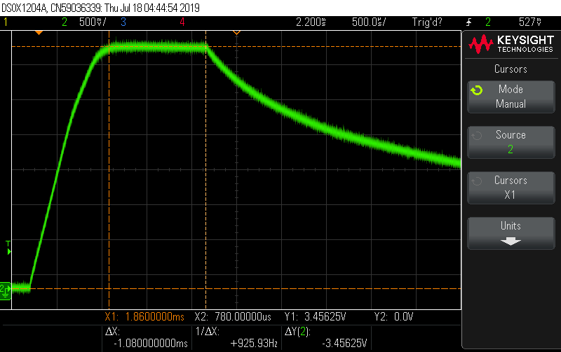

  • Hi Daniel,
    On one failing board, I replaced both external FETs and the IC (TPS51216) itself and the circuit is now working. Could mean a build issue or design margin issue and related to layout.
    On a second failing board, I replaced both external FETs and the IC but instead of the TPS51216, I used the TPS51916 (DCAP2 version) but its still set to DCAP mode with 200k mode pin resistor. However, this board is now going into OVL instead of UVL condition at power-up. In fact, the voltage now raises up to ~3.45V before detecting it's over and shuts down. It stabilizes at 3.45V now which is much higher than before.
    I'm going to try changing the mode pin resistor to 1k (DCAP2 @ 500kHz, tracking) and see if that does anything for me.
