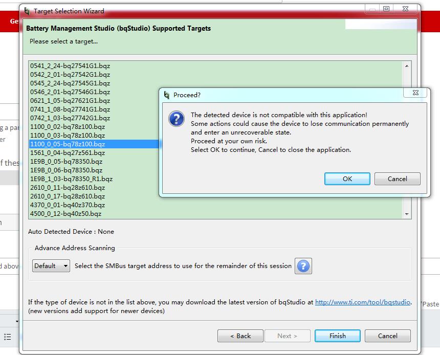

The Battery Management Studio software adds bq78Z100, which gives an alarm prompt; how to set it up to add BQ78Z100 without alarm, and generate the driver software code of BQ78Z100.
It looks like bqstudio didn't recognize your evm or board on initialization. Only then do you have this issue of manually selecting the gauge. Please make sure that your gauge is powered up and awake. You can do this by either having power on bat and pack side of your board or by shorting the bat and pack+ pin momentarily before opening bqstudio.
