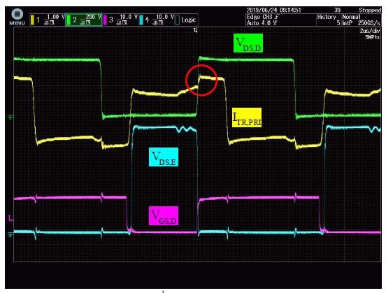

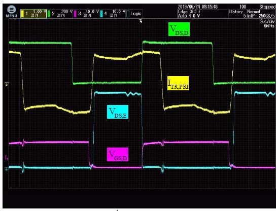

From the above signal, @10A load, when Primary gate drive signal Output "D" turn OFF but SW-D (MOSFET) not completely OFF (Purple color).
And Secondary side output "E" try to turn ON while primary side output "D" still ON
This caused over shoot current (I_TR primary) and LOST at Primary transformer (Yellow color)
But no issue @20A load and >>20A.
Please advise how to solve this issue, or how to configure or add some delay for secondary side output (Output E and F).

    Please check that the probe for the Vgs_D signal is correctly placed - it looks like it is picking up the Vgs_E signal. If this is so then the voltage waveforms make more sense to me.
    Please provide a sketch / schematic showing exactly where you have placed the current probe - ITR_pri. For example, the current in the shim inductor is not the same as that in the transformer primary because some of the current flows in the clamp diodes.
