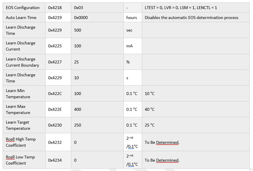

    I don't have a srec to provide. But these are the dataflash setting I consider relevant for the EOS function ad that I have programmed the device with:
  • Sorry, a typo for Learn Discharge Time 0x4229 should be 500s as this is default (long time though...?)
