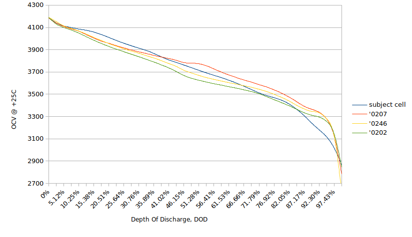

    I have an intention to use all these chemistry data to match my  new cells (when they will arrive) to chem.ID, then just embed T83-T86, T88-T95 of that chemistry to my 'golden image' and reflash the chip. Being a just hobbyist and EE enthusiast  I have no idea to abuse TI by sending them my cells discharge log (and actually I have not equipment to make these measurements automatically so will do it manually, i.e. results are expected to be inexact, just rough approximation, so I simply cannot do it) and asking them to match it.
    To achieve that, I built per chemistry OCV @ +25C, put them into into excel table and reserved a space to enter target cell's OCVs, 40 point at all. Then excel  calculates a distance between these vectors and after ranging them I have a few closest chemistries IDs. Then I am going to consult sluc138dj, to see these IDs' known cells and choosing the ID whose cells have matching chemistry/load capability. This second step is to get best matching cell impedance. That is it.
    How do you think, will this approach be working [good enough]? The subject battery is from laptop, used at +20C..+25C. How does Ti match cell measurements log against the chemistry? Particularly, do they match cell impedance as well? Likely an answer is in that mathcad plugin of sluc138dj, but I simply have not mathcad to dig a few dipper.

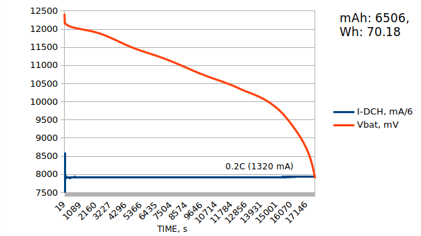

  •  Hello again!
    Your intention to find best chemistry for unknown cells using Excel tables looks like "invention of bycicle". Too much job just for one battery, having in view that TI already did that job and realesed online Chemistry Selection Tool as well as you noticed a MathCad plugin for offline calculation. Just try one of them.
    You need to make not too complicated setup, C/6....C/8 load for battery (12V car bulb for example, precise load is not required), and SMBUS data logger, if you not have ev2300 the workaround could be even Arduino board with 2wire library. Working scetches could be found on the net.

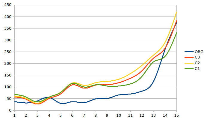

    I am not sure whether cell's impedances are main factor for best chemistry selection. Those values will be recalculated by the gauge on qualified discharges and updated to eeprom even if initial tables are far from actual values. Ra-tables contained in chemistry profile normally characterised for single cell (1S1P). Really in laptop batteries used 1P, 2P, 3P cells connection schemes. Impedance of parallel cells decreased significantly in comparison with single cell, but initial chemistry profile Ra-tables NOT CORRECTED for number of parallel cells, when uploaded to the gauge. So until first successive learning cycle carried out, IT algorithm has potentially increased error in calculation of parameters where Ra-tables are involved. The workaround to this is Golden Image concept.
  • Hi Igor,
    Thank you for your kind replies here in this post. You are absolutely correct in all your statements.
  • Hi Igor,
    Thank you for the hint! I mean Ra tables. So, it they are for 1P, then having 2P configuration one should simply half the values there, right? It can be inexact, but still better than 1P, providing lesser error, faster IT algo learning

    As for "precise load is not required". It seems your advice of C/6..C/8 is in contradiction with slua372r, which recommends discharging at C/20 rate (p.3). If I understand correct, after 20 iterations (at C/20) we earn whole 1C from the cell, and it gives us 20 DOD points. A question where we take remaining 20 points (as T83-T84 have 40 nodes) is still open, though (should we use C/40 instead or just consider it as PWL function? this latter case not seem to be correct - otherwise why TI uses 40 point and not 20 of them?).
    Using your C/6..C8 approach we get only 6 to 8 points, so still unclear from where we  take remaining...
    Thanks!
  • Igor,
    Thank for sharing your thoughts, now I know how to automate the process of OCV taking. Initially I thought to test a cell separately from the battery. This approach yields the issue of the load connect/disconnect at certain time, manual voltage measurement, too huge efforts for lazy guy as me ))
    However nothing  prevents us from detaching a load from battery using FET management command, right? And there is a command to read the cell voltage too. Any cell. so having 1P cell stack for a test time we can can manage a load, can take precise voltages from cells. Just a matter of not too complicated shell scripting! Thanks, Igor. Your ideas bright like a diamond!

    PS.We got, BTW, an answer to "Why to re-invent wheel, by using an excel table and not just TI
    online chemistry matching tool". Do you remember, Igor was asking about this? So an answer is: just because
    the results received from the online matching tool are useless in general, at least without TI's employer kind help
    in getting these table data by ID. Excel approach could potentially help to avoid that by finding the closest chemistry
    from that we have already. Well it could be not such precise matching as achieved with using modern chemistries,
    but it should be sufficient for casual use (presumably). We [EE enthusiasts] are not going to launch space rocket,
    right? )) Just re-animate the battery for our lovely device. But maybe one day you will have something like to
    "Download chemistry data tables by ID" on your website, or even a few a links to download right in the chemistry
    matching report that you send, who knows.
    OCV per DOD taking process is almost completed (maybe 1-2 days remaining, now at 3V6), BTW, It would be curious
    to see if/how good this way does work.

    In meanwhile OCV taking was completed, and I got a few best matching chemistries using excel way. As the measurements did not fit to
    to DOD intervals of 2.56% (100/39) perfectly, an exact values were calculated by considering the measurements as piece wise linear
    function and taking corresponding values using containing interval slope and offset.
    Attached the result. Could you please comment it?
    Particularly, is this reported chemistry ID 2141 close enough to that I got (IDs 0207, 0246, 0202, 0232, 0281, 0285 - best matching first).
    Thanks!

    The battery is a Sony 18650VTC6 with a 3000mAh capacity. It's chemistry is NiCoMn/Carbon. The default Ra tables for it are what I gave you before.

    Thanks for the hint. Actually, Ra tables were updated only during second discharge. First discharge did not affect them. Only Qmax values were updated. There is what I finally get for Ra:
    For me it looks as shifted to right, comparing with your provided Ra (blue line, halved due to 2P). So I am wondering if my cells are 4V2 and not 4V35 (were sold as 4V2)...
    Well, yet another issue. Design capacity was set to 6600. After cells connection full charge cap. was reported back as 6269. Then during two cycles Qmax were updated to:
    6831,6773,6797, and entire pack Qmax is 6773. That is as expected, perfectly matches  discharge curve. BUT the pack still reports lower full charge capacity of 6268. Is it expected? Or I did miss something? Also update status (clz 82+12) is not 0E as per datasheets, but 0D instead.
    Any hints would be very welcome.
    Thanks!
    The pack capacity is reported to be the Qmax of the cell with the least capacity. FCC depends on load rate, so when unloaded or dsg at C/100 your FCC would nearly be Qmax, but if you use a C/2 rate of dsg, depending on chemistry, temperature and other factors like cell heating, your capacity can vary and be a bit less or a lot less than your Qmax.
  • Hi Batt,
    yes, I understand that capacity depends on the load. But actually I was able to take 6506 mAh (at 0.2C rate) off the pack, while it reports 200 mAh lesser. But it is okay for me, even if a bit odd.
    Will fix design capacity :D
