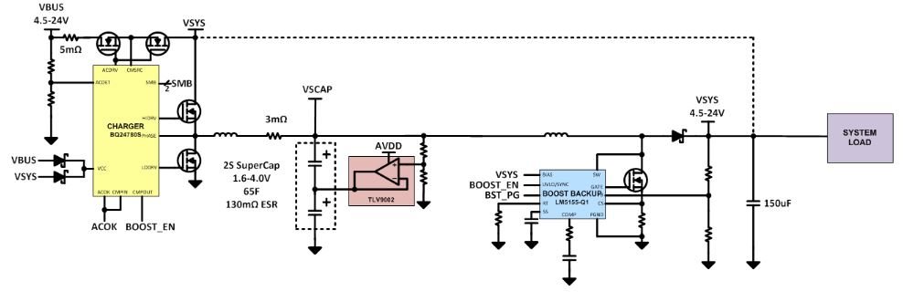

I have an application where I/P is 24V and Load requires V in the range 22-24V.
I want to implement Back-up Power path using SuperCaps(series) when in power outage(Source is disconnected) at the source to give output Voltage in the range of 22-24V.
* If I use 2.7V Supercaps (series of 4 to make 10.8V).This IC can boost the 10.8V to make 24/22V right? OR Do I have to use series SuperCaps stacks up-to 22/24V?
* If I have to implement Back-up Power path using this charger IC how do I do that? OR are there any charger with Back-up Power Patch controller?
