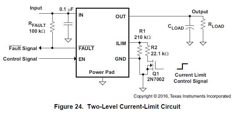

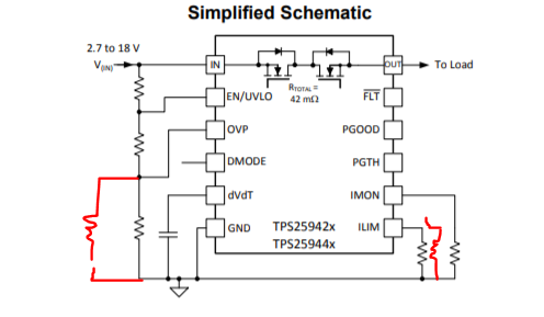

Hi Team,
Customer want to use TPS25942A as power switch for type-C output.
Do we have such experience for this part as type-C power switch?
They want to know is it possbile for TPS25942A to change current limit and OVP after device enable.
