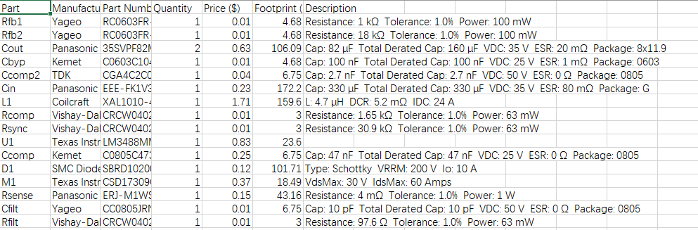

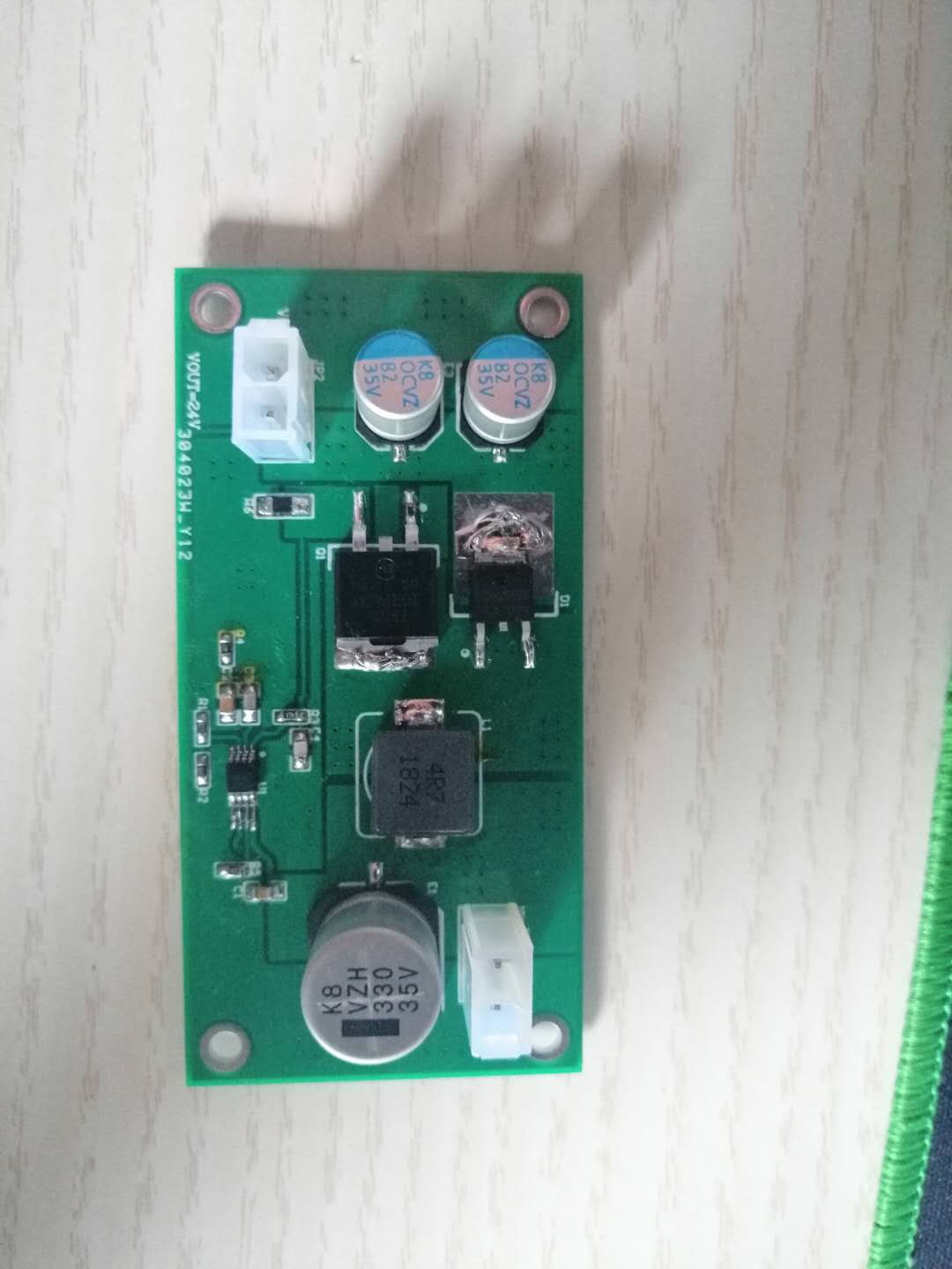

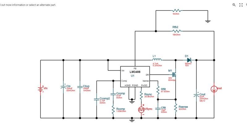

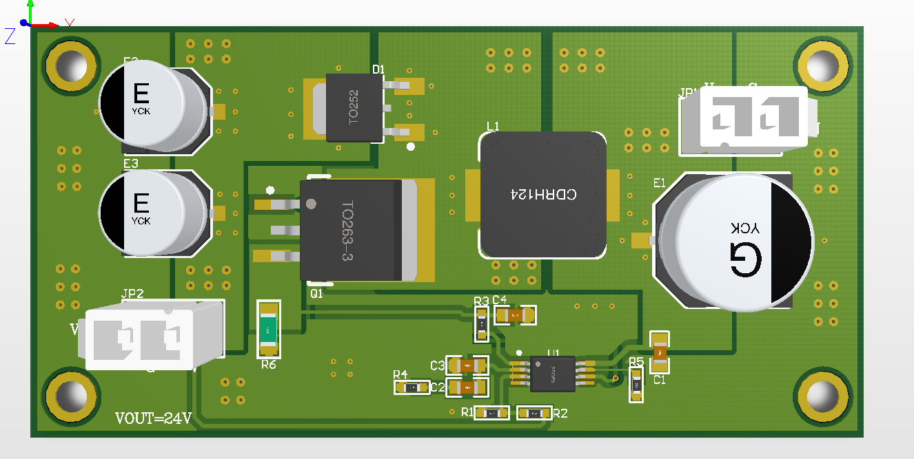

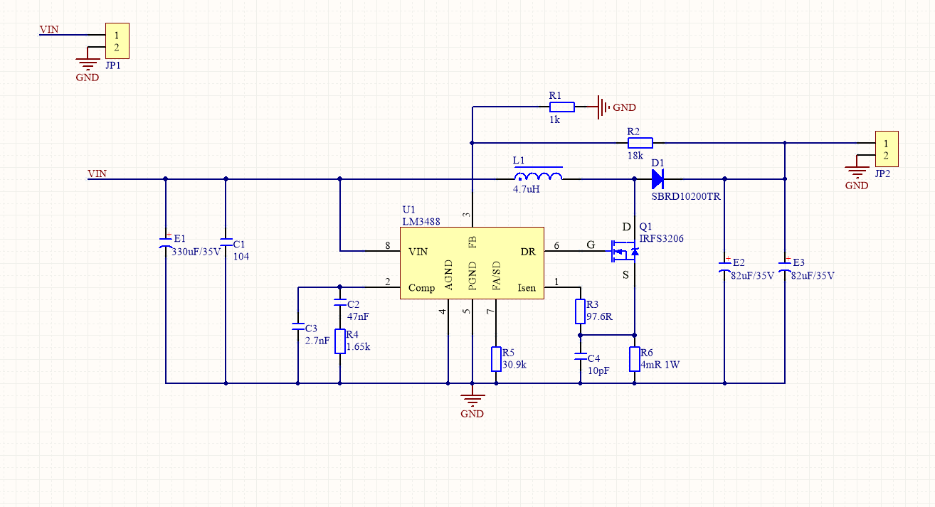

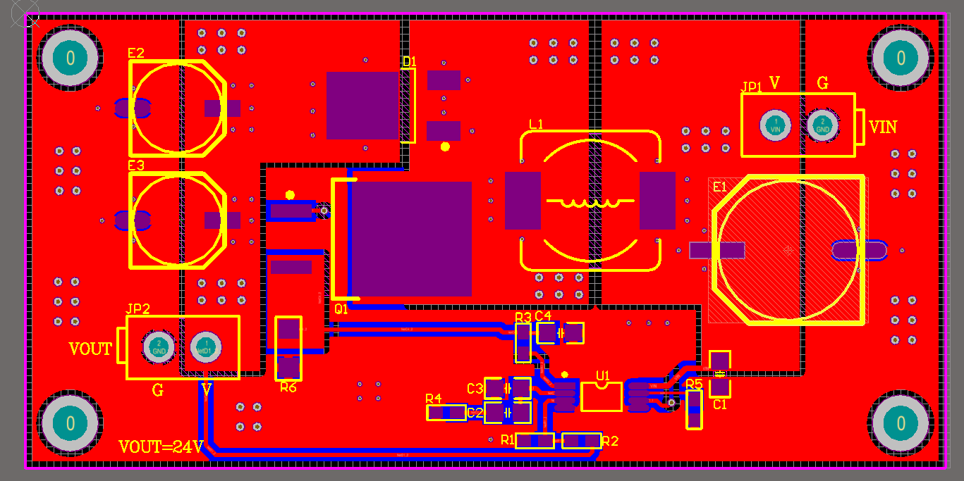

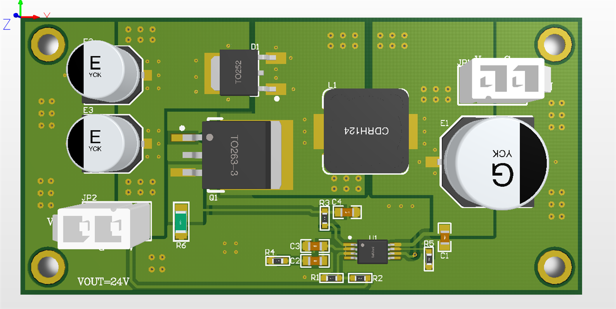

In this design, I used the LM3488 as a boost circuit. The input voltage of the circuit is 12-18V, the output voltage is 24V, and the output current is 6A. I used the WEBENCH help me to finish the design. The following is the schematic of WEBENCH's circuit and my design circuit and PCB. The problem now is that after the input terminal 14V/2A, the output is not normal, and the input is pulled down to a constant current modeof about 5V.

    Can you take a picture of your hardware test setup? I'm thinking there may be an issue with either your power supply or the physical board because the circuit schematic seems to be ok.
    I would check the board and see if there is a short anywhere. Is your power resistor rated for the appropriate power?

    If the issue is still repeatable, then this may be a circuit schematic issue.
    Does replacing the 330uF input capacitor with a lower capacitance, maybe around 47uF, solve this issue?
    When you have a big discharged capacitor, it will seem like a short at startup, which can cause your power supply to source a lot of current to charge this capacitor, which may be the source of the issue you are seeing.

    In that case, can you take a scope shot of the switch node and comp during the non-working conditions? That will help find out where the circuit is not functioning as is.
