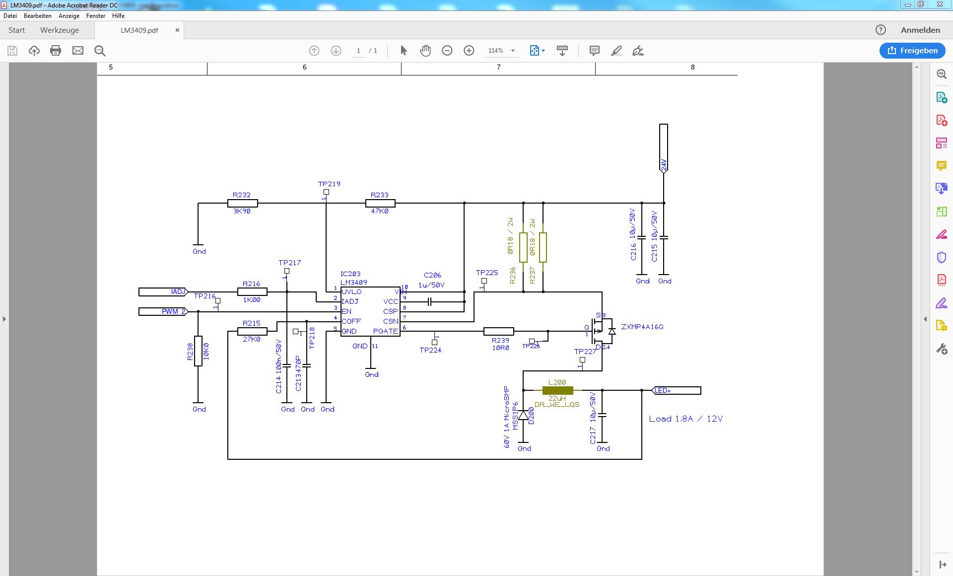

We use the LM3409 for a LED modul
Vin 22V-26V
Iout 1A (0,2A – 1A Analog Dimming)

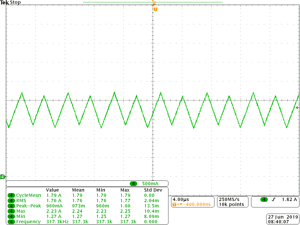

 Now we have problems with the line regulation. Over the input voltage the output current vary form 0,9A to 1,1A.
We think that the output current should be constant over the input voltage.
