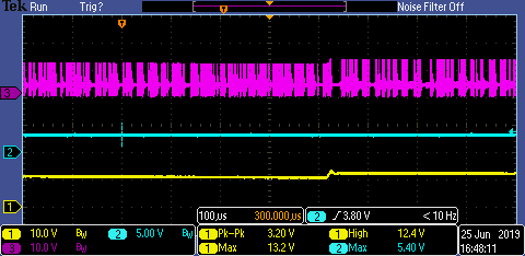

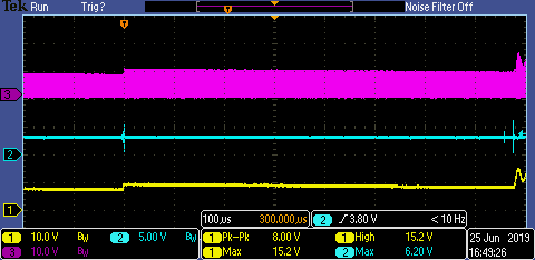

I used "PS54240EVM-VSON Regulator Evaluation Module" to do my experiment. I randomly repeatedly plug and unplug input at VIN terminal, I found there was a high voltage at VOUT (up to 6.2V).
The output of this evaluation module is 3.3V. My question is how to solve this high voltage.
Channel 1 (yellow) showed input power (12V), channel 2 (blue) showed output waveform, and channel 3(pink)  was measured at PH terminal.
    Are you referring to 6.2V spike on the output which is the blue waveform?
    It seems that the spike is not aligned with the PH node waveform, do you have anything else that might be causing this noise?

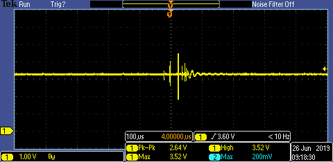

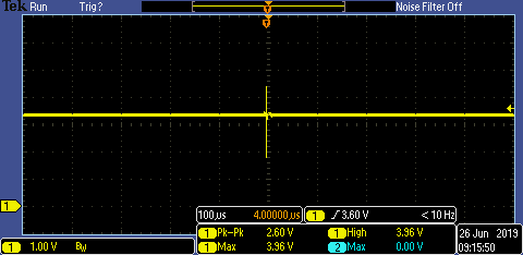

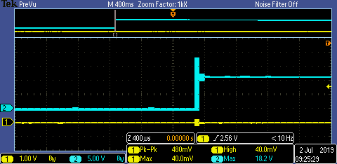

  • dear Sir,
    I connected enable pin to ground and measured output (channel 1) and input (channel 2) waveform.
    It seems that there could be some coupling from the input?
    Is there a way to reduce spike on the input? Maybe try to slowly ramped the input voltage?
    Another way to reduce noise at the output is to use a ferrite bead at the output as a secondary filter or use a post regulator such as an LDO
