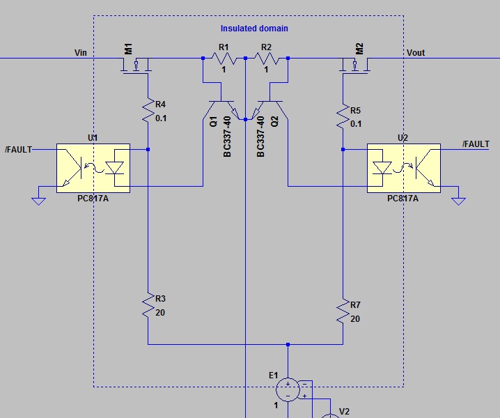

  • Of course,
    is fairly simple idea; basically we plan to use a standard mosfet current limiter circuit but instead modulate the mosfet we turn on an optocoupler that disable the gate drive.
    Here a schematic were E2 could be UCC21220. as you can see if the drop across R1 goes over the Q1 Vbe a current start to flow inside the optocoupler and we can get a signal that switch off the gate drive in less than a us but the current is limited only by the gate resistor. If we want high commutation speed I think i'll we reach value uncompatible with the UCC21220 output.
    What do you think ? Is there a most suitable solution to get an high voltage bidirectional switch with us switching time and current limit ?
    Thank in advance
    Stefano
  • Hi Stefano,
    Thanks for sharing your schematic. I assume you mean E1 could be UCC21220, instead of E2, please correct me if I’m wrong. Is the 1 Ohm the final value? What is the desired current limit fault level? Could you share a bit more of your schematic?
    Does the fault signal/current limit need to latch on? Whenever E1 pulls low, it will also stop the flow of current through the opto-coupler, turning the Fault signal low.
    What is the value of Vin and Vout? Do you need basic isolation, or just functional isolation?
    You might also be interested in our single channel isolated drivers with protections, like the ISO5451. This driver integrates a DESAT protection circuit with integrated fault monitoring output, which could replace the optocouplers and BJTs in your circuit. The DESAT threshold circuit can be level shifted using Zener diodes, and additional resistance in series with the FET drain-source path like R1 and R2.
    Thanks and best regards,
    John
  • Hello John,
    you're right, E1 represents the UCC21220. The current limit treshold should be around 600 mA so probably we need to increase the sense resistors to 1.2 ohm.
    The standard working current is 300 mA max
    There isn't too much around that circuit, we have an FPGA that can handle the fault signal and latch it.
    Vin is an analog signal with value between 10  to 150 V.
    We need only functional isolation for this circuit.
    ISO5451 seems nice but is not clear to me how to adjust the treshold.
    Is there an application note about the use of ISO5451 with mosfet ?
    Thank in advance
    Stefano
  • Hi Stefano,
    How precise does the 600 mA current limit need to be? On second look, the DESAT circuit in ISO5451 probably has too much variation (8.3 to 9.5V) to be used as a precise cutoff in this circuit. It would be nice in theory, but I don’t think this driver will work for you. See this thread on adjusting the DESAT threshold.
    https://e2e.ti.com/support/power-management/f/196/p/796343/2946036
    Looking back at your posted circuit, I think this would work okay, considering the FPGA can maintain the fault flag. You might want to place a current limiting resistor (~100-1k Ohms) in series with each LED in the Optocouplers, in order to prevent them from conducting too much current from UCC21220.
    How will the VDD-VSS voltage be generated for UCC21220?
    If this answered your question, could you please press the green button? If not, please feel free to ask more questions.
    John
