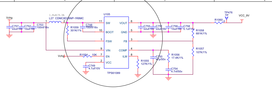

Dear all:
      I used TPS61089 to design the 4V booster circuit of 9V, as shown in the figure below.During the test, it was found that I used the voltage regulator to input 4V, and the output voltage was loaded. The output voltage would drop regularly, please help me check it?
Thank you!
