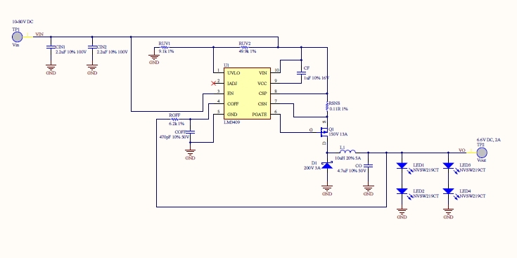

Hi Support,

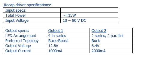

Based on below requirements, please review the schematic.
Hi Ikon,
Just based on your input voltage spec of 80VDC, this will not work. The max recommended input voltage for the LM3409HV is 75V. The other issue is that the LM3409 is only a Buck converter.
Thanks Tuan
