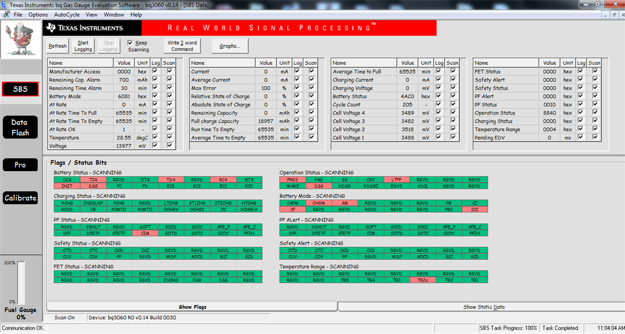

Hi. We have a problem with a battery pack which has BQ3060.
It has CIM permament failure, but we have balanced the cells and want to clear the failure.

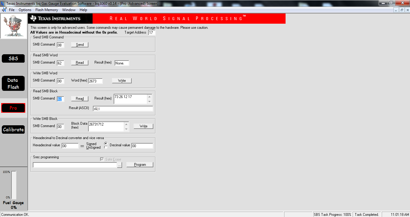

I followed the steps from BQ3060 technical reference, but with no success:
1. I read the PFkey from 0x61 address, which responds with 73 26 12 17
2. Afterwards I write the PFkey to ManufacturerAccess(0x0) first - 17 12 and then 26 73, but the CIM flag does not disappear.
Can you please help me understand why this happens? Below are image of flags:
