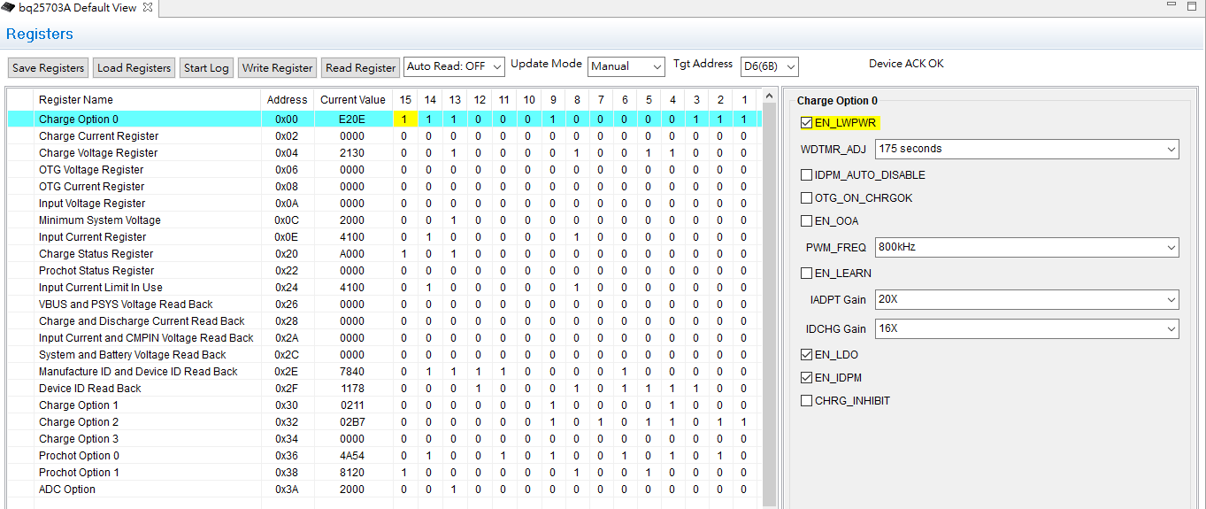

  • Hi Joel,
    I understand NVDC architecture can let system works when battery voltage below minimum system voltage.
    But if battery is totally removal? Is it still work?
    I have tried to provide VBUS 5V and disconnect battery, then set REG0x0D/0C minimum system voltage to 8192mV on BQ25703A EVM,
    But BQ25703A only output about 2.8V.
    Below is my GUI setting on EVM board, could you help me to check there have something wrong?
  • Hey Jeff,
    Is this on the BQ25703AEVM or a custom board?
    Does the converter regulate VSYS normally when the input voltage is at 6V?
    Do you have a load present on VSYS at the time you apply the 5V input?
    Are you using the integrated independent comparator? I noticed you have the FORCE_LATCHOFF bit flipped on in ChargeOption1.
    And last question: Do you have an image of the BQStudio GUI registers when the charger is operating? In other words, does the above image represent the settings you program only, or what you read from BQStudio once the charger is operating and VSYS has fallen to 2.8V?
    Joel H
  • Hi Joel,
    Sorry, I found my JP6 is turn on, connect to GND, caused BQ25703A into Hi-Z mode.
    After turn off JP6, it is normal work now.
    I will close this case.
