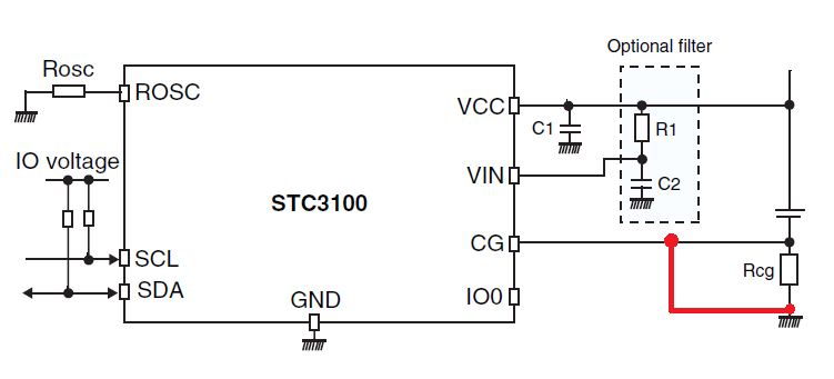

However, we wanted to changed our design by adding a coulomb counter, so we faced a major problem with the Boost mode provided by the BQ24195L:

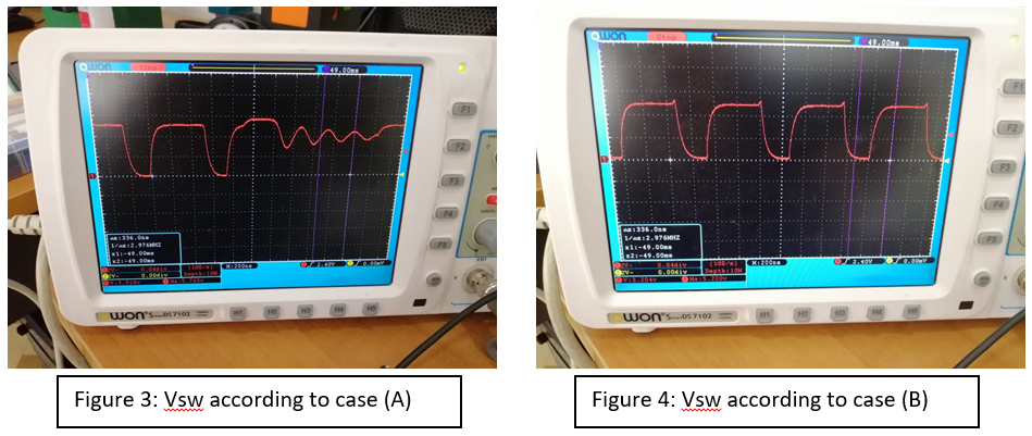

so in the last project we were working on, the PMID voltage was stabilized at 5.1 V regardless of the current consumption ( max 1 A ) , but in the new one , the PMID is generating 5.1 V when there is no load and the voltage starts to drop progressively ( from 5.1 V to 4.6 V ) wen the current drained by PMID starts to increase ( Max 1 A ) .

    Also, could you please send me more details about the coulomb counter schematic and how you are measuring from it? Are you measuring VBAT at the pin?

  • Hey  Ricardo,
    First of all i would like to thank you for your support services.
    Let me explain in details about the issue we are facing in the new project knowing that the old one is working properly.
    Here is the schematic of the Coulomb Counter that we are using in the NEW project. We have shorted Rcg the shunt resistor to make sure we have the same reference ground all over the board just for troubleshooting purposes (the problem remains the same) :
    The Best way to diagnosis is to compare the OLD project (in which PMID is stable at 5.1 V regardless of the current consumption) to the NEW one (PMID is Dropping down).

    We have mounted the same components in both projects, based on the application note of TI. I think that the control of the boost converter that adjusts the duty cycle (or any other parameter ) of its dedicated MOSFET in order to provide a stable output (V PMID = 5.1 V) regardless of its drained current (0 < I < 1 A) is not working properly.

  • Hi Elie,
    In boost mode, the LSFET cycle-by-cycle current limit (IOTG_ILIM) is 2.76 A min and 3.8 A typical.  If the charger is hitting the cycle-by-cycle current limit, the duty cycle will be clamped and the output will droop. Just to confirm, you are using the same inductor in the new project as the old?  Do you have a method to measure the inductor current?   If the inductor is saturating, the current will spike and hit IOTG_ILIM.
