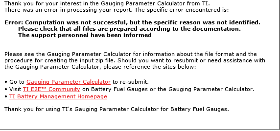

  • Hi Batt,
    on behalf:
    Fuel gauge BQ34Z100-G1 the GPCRA0 cycle is performed, report email received from gpc_do_not_reply@ti.com, but unfortunately its empty. The report and error email image is attached for reference.
    Looking forward for feedback or support.
    BR,
    Adrian
    GPCRA0-report.zip
  • Hi Adrian,
    Why do you need GPCRA optimization? A normal chem ID has a wider range when left at defaults. You have a chem ID already, you don't need to do further optimization unless you are getting really bad accuracy with it.
  • Hi Batt,
    Chem ID is obtained, as we discussed earlier in this link where the Ra values for a lower cap cell will be different from the other cell that it matched. The GPRCA is performed to verify the Ra and Qmax tables, but unfortunately we didn't receive report.
  • Hi Reddy,
    To get the correct Ra values for your battery after you found out the chem ID, you should run a learning cycle. Now a GPCRa cycle helps with Ra0 optimization incl thermal parameters, however, your learning cycle is necessary before this is performed. This will optimize your learned values for a room temp run.
    Please run a learning cycle first so that your Ra values can be determined.

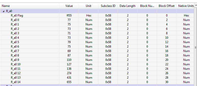

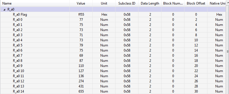

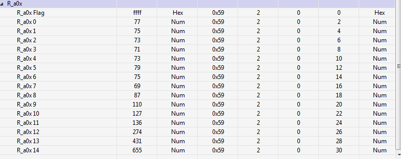

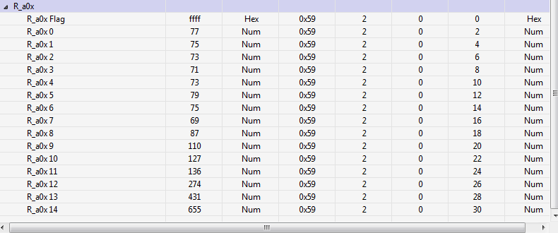

  • Thanks Batt,
    The learning cycle has been performed, before GPCRA.
    please go through the images.
    Charge
    Discharge
    Thanks in advance!!

  • Hi Reddy,
    The screenshot shows that the battery has not learned. If you did learn resistance, it will have updated the Ra flags in the first cycle to 0x0055 and in the second cycle to 0x0000 and 0x0055. Please make sure your battery is relaxed with RDIS reset before starting your charge and dsg cycle when you run your learning cycle.
  • Though this document was made for another product, you may find this useful for running your learning cycle,
    . Please see if this helps.
