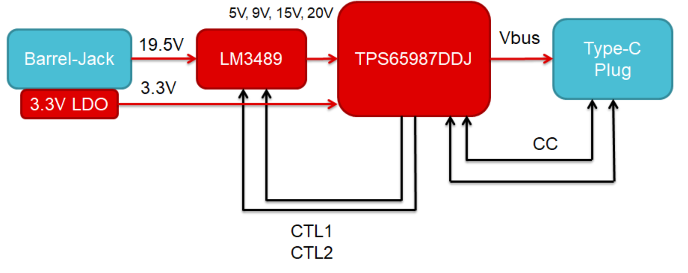

This is a high level of my design. I am using the LM3489, but I was looking for different alternatives or suggestions to my design.
