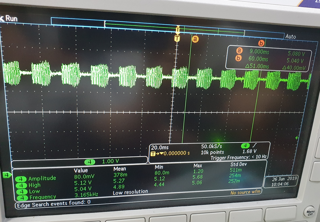

I'd like to ask for your help with the following:
- Problem -
Problem: MCU sometimes doesn't work.
The MCU does not operate when the review results in a sound on the board, and MCU operation stops when outputting from the 5V output to the graph shown below.
After a period of time, the MCU will operate again after returning to the normal 5V output.

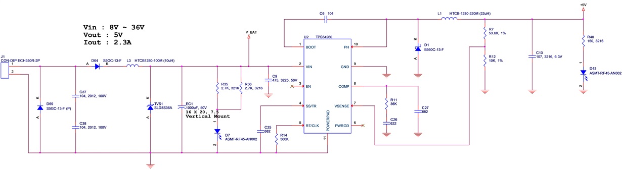

It outputs 5V with TPS54260 and is designed with WEBENCH® designs. Below is the TPS54260 design circuit.
I want to know how to solve this problem.
