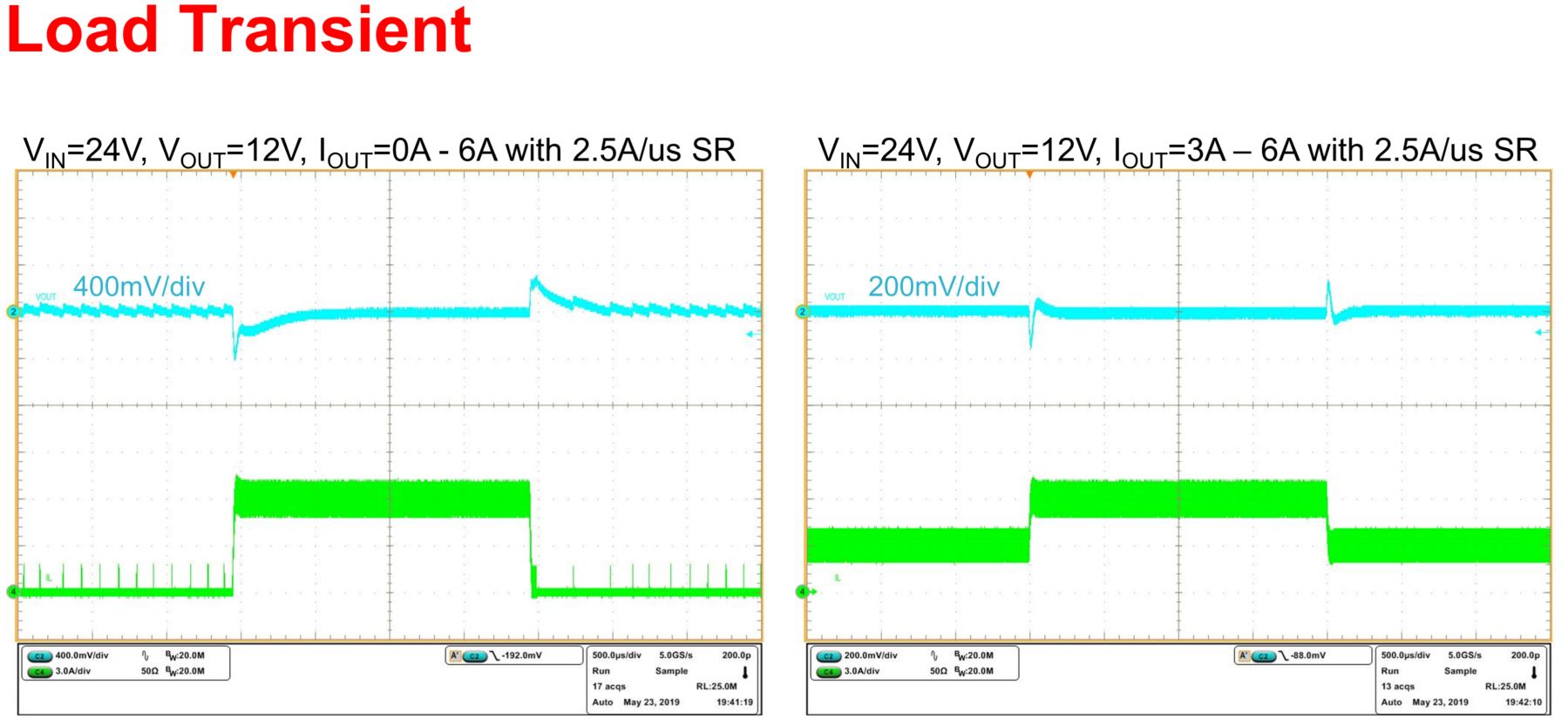

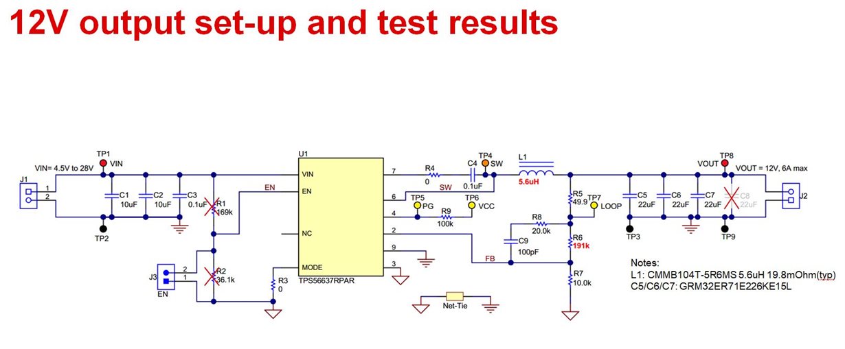

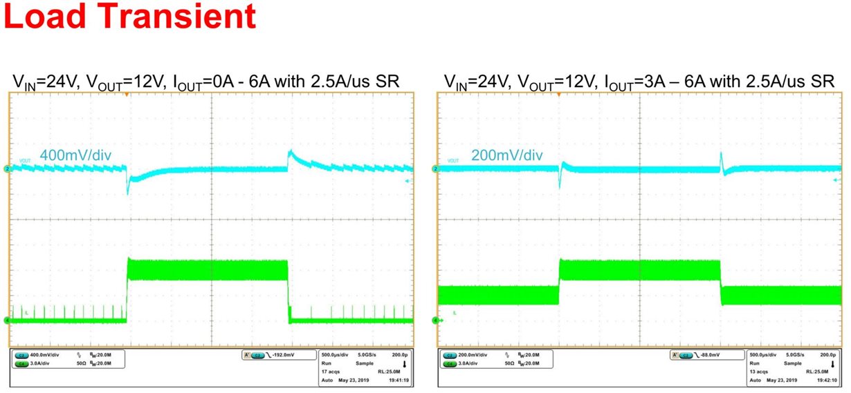

Hi team,
My customer would like to know the performance of load transient response of TPS56637 as following condition. If you have a data with similar condition, could you share it?
- Vin=21.485~24.15V,  Vout=12V, Load transient range= 1.5A (e.g. 1.0A to 2.5A), Slew rate : 1A/us, target drop voltage = within 800mV.
